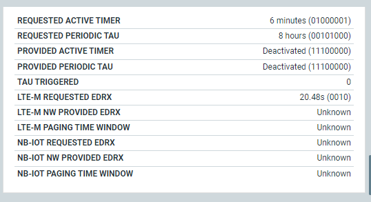

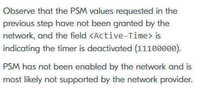

i'm learning the exercise1 for AT commands to control modem and when i apply this command AT%XMONITOR i get the output as %XMONITOR: 5,"","","24202","0901",7,20,"02024720",428,6300,52,36,"","11100000","11100000","01001001" PSM not enabled and after following all steps until the end of the exercise nothing worked as example showed like if i run AT+CEDRXRDP the output comes like +CEDRXRDP: 0 OK.
is my LTE-M provider gives this feature or not? how can i see and why i can't see the original output as the exercise showed me.
i assume that this is my feature that cellular monitor gives me the information if you need
