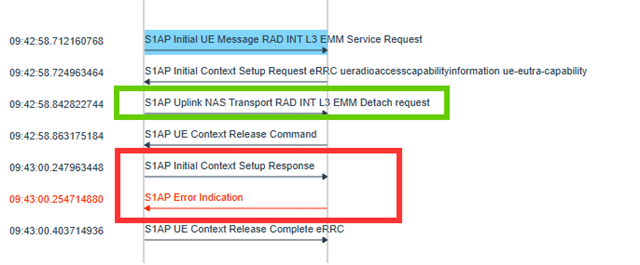

We also received the following images when again asking if they could see why device went offline.
Not sure if related as the device succeed to connect a few minutes later.
More interestingly might be that they can see that device switch between using LTE-M and NB-Iot.
Another time they report that device request release from network and networks never sees it again.
