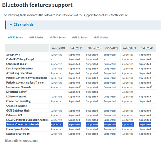

to deal with an ESB dongle. Given the 7.5ms minimum connection interval of
pre-6.2 BLE and that (in my experience with the hardware I have at hand) most
consumer centrals offer 11.25ms minimum CI, it seems that BLE might not be
ideal for my target polling rate and latency.
I have a few questions:
1. How widely available in consumer hosts is Shorter Connection Intervals at
the moment? I know these things take a while to make it to the consumer market.
2. Having a quick look at retailers it seems very hard to find a Bluetooth
dongle/PCI card that supports anything above Bluetooth 6.0. Since SCI was added
in 6.2, does that imply that these won't support SCI?
3. Since I'll need to ship a dongle anyway, would it be possible for it to act
as a HCI USB that offers BT 6.2 to the host? What BT stacks in mainstream
operating systems offer SCI?
