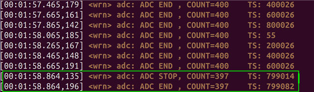

  • Well, I moved to the implementation and I did face the issue indeed with my nRF52840-DK.
    Here is a snapshot of my logs coming from my SAADC ISR Handler:
    I am expecting an END event with roughly 200ms interval, which is the case. Then, I trigger the TASK_STOP of the ADC and I expect the STOPPED event to occur. This is also the case (the last line -1). A few microseconds later, the END event also occurs (last line)
    static void saadc_handler(void)
        if (NRF_SAADC->EVENTS_STOPPED) {
            NRF_SAADC->EVENTS_STOPPED = 0;
            full_buffer_idx ^= 1;
            data_item_type data;
            data.timestamp = unixtime_get(NULL);
            LOG_WRN("ADC STOP, COUNT=%d    TS: %lld", NRF_SAADC->RESULT.AMOUNT, data.timestamp % 1000000);
            k_msgq_put(&my_msgq, &data, K_NO_WAIT);
        if (NRF_SAADC->EVENTS_END) {
            NRF_SAADC->EVENTS_END = 0;
            LOG_WRN("ADC END , COUNT=%d    TS: %lld", NRF_SAADC->RESULT.AMOUNT, data.timestamp % 1000000);
        if (NRF_SAADC->EVENTS_STARTED) {
            NRF_SAADC->EVENTS_STARTED = 0;
            //toggle buffer index and update sample buffer for next adc start
            next_buffer_idx ^= 1;
            nrf_saadc_buffer_pointer_set(NRF_SAADC, (nrf_saadc_value_t *) m_sample_buffer[next_buffer_idx]);
    Here is my handler:

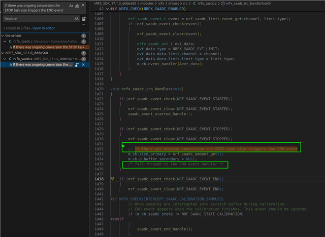

    I did find out, where I read this information: It is in nrfx_saadc.c driver.
    --> Follow up question: what is meant by "ongoing conversion": does it mean that ADC is actively doing a conversion, or the buffer is still not full (RESULT.AMOUNT < RESULT.MAXCNT)?
  • Hi Ianwer,
    Sorry for the late response. It is correct that the STOP task will also trigger an END event if the STOP task is triggered during an ongoing transaction. That brings to your second question
    The "ongoing conversation" that a SAMPLE task has been triggered but an event is not generated saying that the EasyDMA is done with the transaction/transfer.

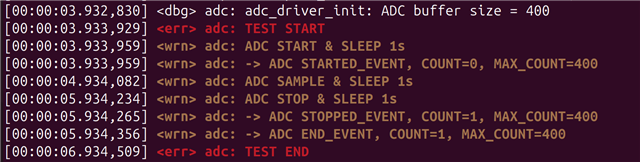

    I simplified my test setup because I consistently observed that EVENT_END occurs after triggering the STOP task and receiving EVENT_STOPPED when RESULT.AMOUNT < RESULT.MAXCNT. To isolate the behavior, I removed all timing dependencies (timers and PPI channels) and reduced the setup to the following minimal example:
    // Init ADC
    sensor_adc_init();
    // Start the test sequence
    LOG_ERR("TEST START");
    LOG_WRN("ADC START & SLEEP 1s");
    nrf_saadc_task_trigger(NRF_SAADC, NRF_SAADC_TASK_START);
    k_sleep(K_MSEC(1000));
    LOG_WRN("ADC SAMPLE & SLEEP 1s");
    nrf_saadc_task_trigger(NRF_SAADC, NRF_SAADC_TASK_SAMPLE);
    LOG_WRN("ADC STOP & SLEEP 1s");
    nrf_saadc_task_trigger(NRF_SAADC, NRF_SAADC_TASK_STOP);
    LOG_ERR("TEST END");
    This is the my saadc handler implementation:
            // If there was ongoing conversion the STOP task also triggers the END event
            /* fall-through to the END event handler */
            LOG_WRN("-> ADC STOPPED_EVENT, COUNT=%d, MAX_COUNT=%d", NRF_SAADC->RESULT.AMOUNT, NRF_SAADC->RESULT.MAXCNT);
            LOG_WRN("-> ADC END_EVENT, COUNT=%d, MAX_COUNT=%d", NRF_SAADC->RESULT.AMOUNT, NRF_SAADC->RESULT.MAXCNT);
            LOG_WRN("-> ADC STARTED_EVENT, COUNT=%d, MAX_COUNT=%d", NRF_SAADC->RESULT.AMOUNT, NRF_SAADC->RESULT.MAXCNT);
    And this is the corresponding output:
    Conclusion:
    With this simple setup and by removing all timing dependencies, I am fairly confident that the adc does always generate an END_EVENT after the STOPPED_EVENT when the SAADC is stopped with RESULT.AMOUNT < RESULT.MAXCNT, even if the ADC was not actively converting at the time the STOP task was triggered. I tried to rule out stopping during an active conversion by waiting one second after triggering the SAMPLE task before triggering the STOP task.
