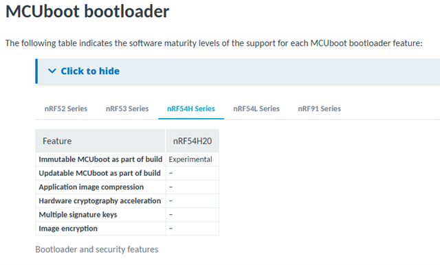

From the current documentation and samples, my understanding is:
On nRF54H20, the boot sequence is Secure-Domain based and cannot be disabled.
NSIB / B0-style immutable bootloaders are not supported on nRF54H20
SUIT was previously used bootloader updates, but from NCS 3.1.0 and later it appears deprecated / removed
Current DFU guidance focuses on MCUboot-based application updates only
MCUboot itself cannot safely update itself and there is no exposed A/B or rollback mechanism for the bootloader
This leads me to conclude that, in NCS ≥ 3.1, MCUboot is effectively treated as immutable in the field, and can only be updated via SWD / service access.
