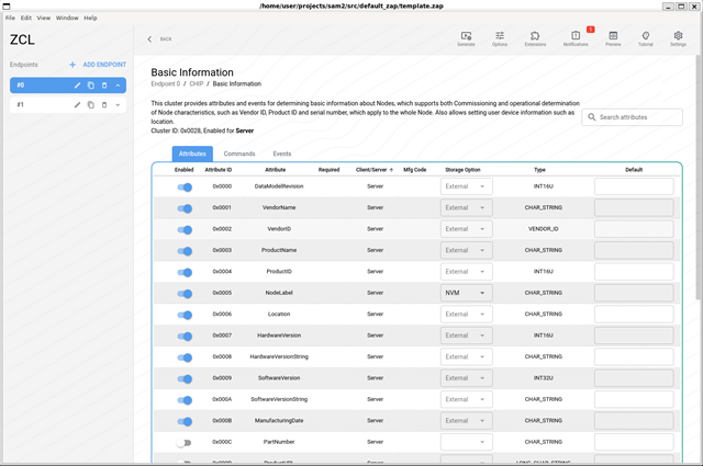

Change default values in BasicInformation cluster attributes in ZAP

To pass this test, I figure that I need to change the default values in the BasicInformation cluster (please let me know if this is wrong).
I would like to know how to change the default values in the BasicInformation cluster, because right now the fields are disabled so I cannot input the values.

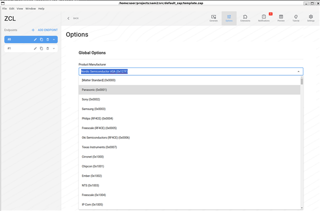

I am still using the Nordic Semiconductor as a product manufacturer. Do I need to register for CSA so that the fields will be enabled and I am able to change the default values?
