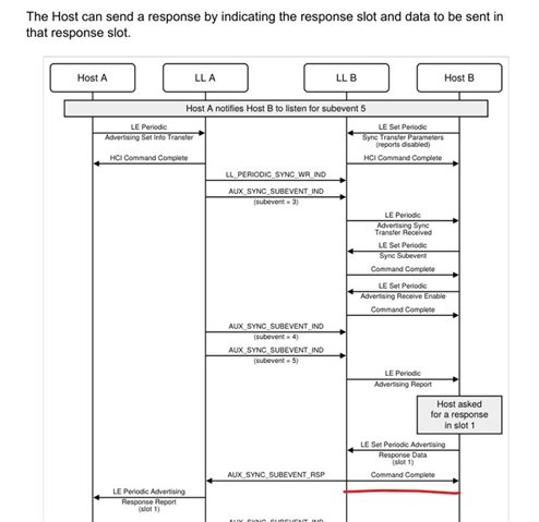

    Setting subevent data is kind of special for the controller, since it is timing dependent.When the Host set subevent response data, the controller must send the data on air before we give command complete.
    Figure 3.13: Using a response slot in PAwR:
    There is special handling to make sure we reject any other HCI command until this has occurred:
    bluetooth: Fix assert when handling illegal response data cmd · nrfconnect/sdk-nrf@d257b1d
