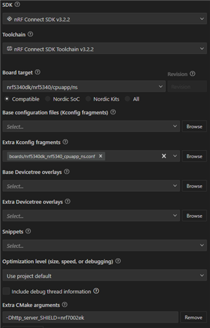

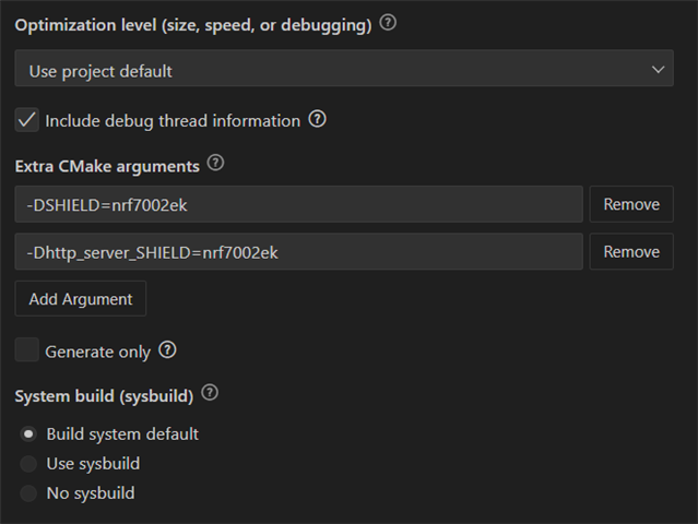

  • It should work with -Dhttp_server_SHIELD="nrf7002ek" to find the network interface, not sure why it also needs -DSHIELD=nrf7002ek in your case. You can add it if it helps.
