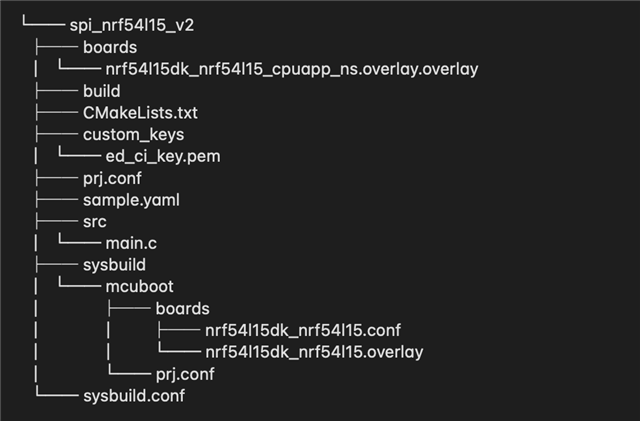

MCUBoot aborts with sysbuild/mcuboot layout for nRF54L15DK
In the latest nRF Connect SDK 3.2. , I've been having a few "sysbuild/mcuboot/boards" folder layout issues with nRF54L15DK / nRF5340DK when using external device FLASH & MCUBoot.

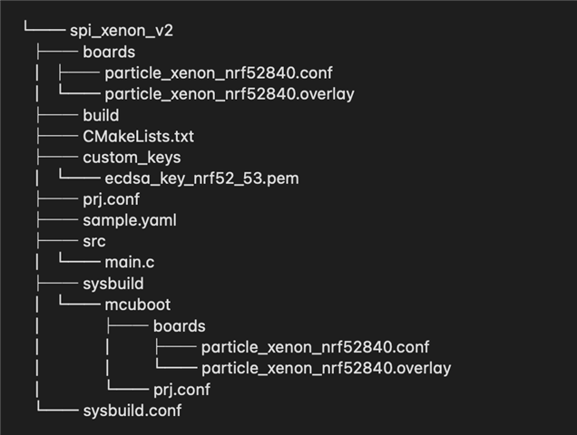

Other existing projects using nRF9150DK and nRF52840 (with 4MB SPI FLASH) boards are successful in builds and application executions.
However, with nRF Connect SDK 3.2.1, the “sysbuild/mcuboot/boards” works for nRF52840 device with external FLASH but not for nRF54L15DK and nRF5340DK.
I think the issue is probably a configuration one but have been unsuccessful trying a few variations.
The issue can be reproduced with the DevAcademy  "Lesson 9 Bootloaders and DFU/FOTA", Exercise 3 – DFU with external flash for nRF54L15DK.
The DevAcademy, l9-exercise 3 "sysbuild" folder layout works fine for nRF54L15DK / nRF5340DK. However, as I typically target the same application for different boards,  I prefer to keep the .conf &.overlay files for the boards in their respective “boards” folder for both the application and MCUBoot.
The layout shown below works fine for nRF9151, nRF52840, and Thingy53 projects with NCS 3.2.1. The layout doesn't work for nRF5340DK and nRF54L15DK.

The following "sysbuild/mcuboot"  layout for nRF52840 device with external FLASH (spi_xenon_v2)  builds and runs successfully.
The issue can be reproduced with "DevAcademy, l9-exercise 3",  with the following "sysbuild/mcuboot" layouts. I don't see anything obvious that may be incorrect with the MCUBoot configuration.
The folder structure used for the nRF54L15 (and similar for nRF5340DK) and conf/overlay files are listed below. The application fails with "abort()" .
I would appreciate if you could please review and check if this layout builds and runs successfully for you on a nRF54L15DK? Thank you.
"spi" project for nRF54L15 using external FLASH.

sysbuild/mcuboot/boards/nrf54l15dk_nrf54l15.conf:
# Enable logging for MCUboot
CONFIG_LOG=y
# Turn on a LED so we can see when Serial Recovery mode is active
CONFIG_MCUBOOT_INDICATION_LED=y
# Enable SPI driver for external flash (MCUboot)
CONFIG_GPIO=y
CONFIG_SPI=y
CONFIG_FLASH=y
CONFIG_SPI_NOR=y
CONFIG_SPI_NOR_SFDP_DEVICETREE=y
CONFIG_SPI_NOR_FLASH_LAYOUT_PAGE_SIZE=4096
CONFIG_NORDIC_QSPI_NOR=n
# required by SPI driver
CONFIG_MULTITHREADING=y
# Increase number of sectors
CONFIG_BOOT_MAX_IMG_SECTORS=512
# nRF54L15 needs some more space for MCUboot.
# so remember to optimize this size in your own project
CONFIG_PM_PARTITION_SIZE_MCUBOOT =0x12000
sysbuild/mcuboot/boards/nrf54l15dk_nrf54l15.overlay:
  aliases {
        mcuboot-button0 = &button1;
        mcuboot-led0 = &led1;
/* Add external flash to MCUboot */
&mx25r64 {
    status = "okay";
    chosen {
        nordic,pm-ext-flash = &mx25r64;
sysbuild/mcuboot/prj.conf:
MCUBoot takes the CONFIG_PM_PARTITION_SIZE_MCUBOOT from "sysbuild/mcuboot/prj.conf" file. However, for nRF52840 / nRF9151, I find that MCUBoot can take the MCUBOOT size value from the board ".conf" file, rather than the "sysbuild/prj.conf".
Question - Is the "sysbuild/mcuboot/boards/nrf54l15dk_nrf54l15.conf" effectively merged with the "sysbuild/mcuboot/prj.conf"? If so, shouldn't the board ".conf" take priority?

    Output build files
    The final merged configurations for an image can be seen in build/<IMAGE>/zephyr/.config. And for DTS, that would be build/<IMAGE>/zephyr/zephyr.dts.
    So for mcuboot, that would for example be build/mcuboot/zephyr/.config.
    Firstly, I suggest that you do some testing and compare the .config and zephyr.dts files for mcuboot between the tests. Specifically with and without "sysbuild/mcuboot/".
    Sysbuild overlay vs overwrite
    If you have sysbuild/mcuboot.conf, this will overlay the original MCUboot configuration. Meaning that it will more or less be appended to it.
    If you have sysbuild/mcuboot/prj.conf, this will overwrite the original MCUboot configuration. Meaning that it will replace the original configration.
    So one guess to what goes wrong in your case is that when you use sysbuild/mcuboot/prj.conf, this will overwrite some default configurations needed for external flash.
    You can compare output build files to see the difference, and hopefully find which configurations you are missing.
    Sigurd Hellesvik
  • Hi Siguard,
    Thank you for the quick response. It's much appreciated as always.
    I'll look into your suggestions. I have tried multiple MCUboot configurations for a few days and compared the application and MCUboot ".config" . I'll try again.
    Regarding:
    Yes, I did compare the default configurations needed for the external FLASH, and had to add "CONFIG_FLASH=y" in "sysbuild/mcuboot/prj.conf" plus extend the MCUBOOT size in the same file for a successful build.
    Does the “sysbuild/mcuboot/boards/<board>.conf” merge with the “sysbuild/mcuboot/prj.conf”? Past usage tends to suggest it.
    Do you mind taking the DevAcademy lesson 9 , exercise 3 (l9_e3) and building & running it for the nRF54L15DK?
    You'll need to restructure the layout as "sysbuild/mcuboot/boards", and change "mcuboot.conf" -> "nrf54l15_nef54l15.conf" and "mcuboot.overlay" -> "nrf54l15_nrf54l15.overlay".
    I think you'll get the same MCUboot abort(). Thank you.
