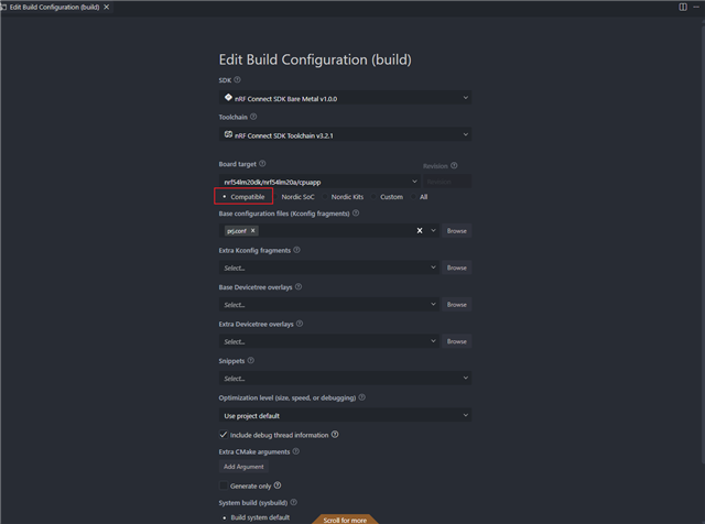

I am testing the radio_test (short-range) sample on an nRF54LM20A DK. The test setup is:

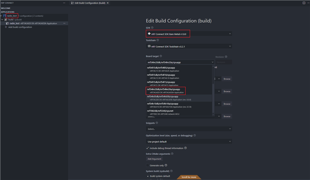

  • Board: nRF54LM20A DK

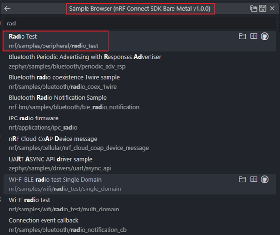

  • Sample: peripheral/radio_test (NCS version: <v1.0.0>) [Radio test]
  • Mode: Bluetooth LE 1M (data_rate ble_1Mbit)
  • Channel: 2400 MHz (start_channel 0) [BLE radio test]
  • TX power: -40 dBm and -46 dBm (very low output power; nRF54L series supports down to about -46 dBm) [54L radio]

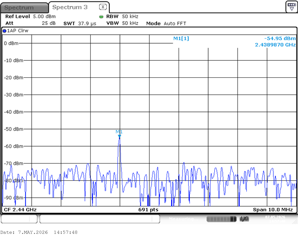

  • After I stop TX and enter RX mode, I still see a continuous wave around -50 dBm on a spectrum analyzer, as if something is still transmitting.
  • This only happens when TX power is -40 dBm or -46 dBm.
  • When TX power is higher than -40 dBm, the problem does not appear: after cancel and switching to RX, no residual CW is visible.

    At neg40dBm and at neg46dBM, what you are observing is LO leakage and that is the normal outcome after start_rx command ( at the beginning or after cancelling the start_rx). So, what we have been observing is normal.
    We have been investigating that why we are not getting any leakage from 0dBM to neg28dBm; either it would be setting on the spectrum analyser (for why leakage is suppressed by noise below approx -60dBm) or it would be software issue.
    I will get back to you lately.
