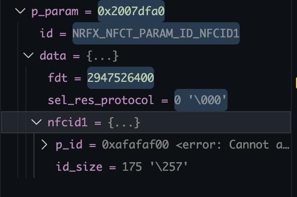

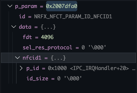

  • What exactly is the issue you're seeing with NFC on your end?
    I'm getting hard fault 50% of the time. If I breakpoint on nrfx_nfct.c::nrfx_nfct_parameter_set(...) and look at the p_param parameter being passed in, it is sometimes good and NFC runs just fine. At other times, the values are garbage and I get an immediate hard fault. The first attached image (fdt=4096) is an example where NFC runs fine. The second is an example where I get a hard fault. These two images were from back-to-back runs.
  • Hi
    And this is on NCS v2.0.0, correct? Is it also reproducible on an nRF development kit so we can reproduce this on our end with one of the sample projects? Does it seem to be happening at random, or is it seemingly random whether you get a hardfault or not?
