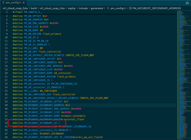

I migrate an app from NCS 3.1.0 to NCS 3.2.3.
Using mcuboot with a Thingy:91 or Thingy:91X fails.
flash_img_init results in a flash_img_context, which uses ID 2, the application_slot0, where the app runs from. That obviously crashes on executing an update.
This seems to be caused by
CONFIG_FLASH_LOAD_OFFSET=0x0
instead of
CONFIG_FLASH_LOAD_OFFSET=0x50000
which, then causes to use slot0 instead of slot1
According the migration guide 3.2 , the
"MCUboot image IDs are no longer taken from sysbuild Kconfig options and are instead automatically assigned."
but that seems to fail.

    The assigned image ID number is not the same as the IDs used for the flash partitions. The image ID does not directly control what mcuboot slot to use. Please check the pm_config.h file in your build/<your project name>/zephyr/include/generated/ to see which partition ID 2 maps to.
    Setting flash load offset is not necessary when using the partition manager. You can confirm the start address in flash from the zephyr.map output.
    Note: you can search your build folder for CONFIG_MCUBOOT_APPLICATION_IMAGE_NUMBER to see what the assigned number is.
    Vidar

  • Thanks. This looks to be an unintended side effect of the commit I found here: https://github.com/nrfconnect/sdk-zephyr/commit/87b1bb8916c913e492e1d37156cb8b846481bb1f. You can see the FIXED_PARTITION_IS_RUNNING_APP_PARTITION() macro depends on the zephyr,code-partition FLASH_LOAD_OFFSET property to determine if the app is running from slot0.
    Setting zephyr,code-partition seems like the best workaround for now. I will report this internally.
    EDIT: I was a bit too quick when reviewing the code and what you said. I assumed the issue was that zephyr,code-partition was not defined in the devicetree for these boards. But see now that the issue is really that the FLASH_LOAD_OFFSET symbol is being set to "0" because these boards are missing the "DT_CHOSEN_Z_CODE_PARTITION := zephyr,code-partition" line as you already pointed out. Without this line, Kconfig can't "see" the code partition defined in the devicetree.
  • Setting zephyr,code-partition seems like the best workaround for now. I will report this internally.
