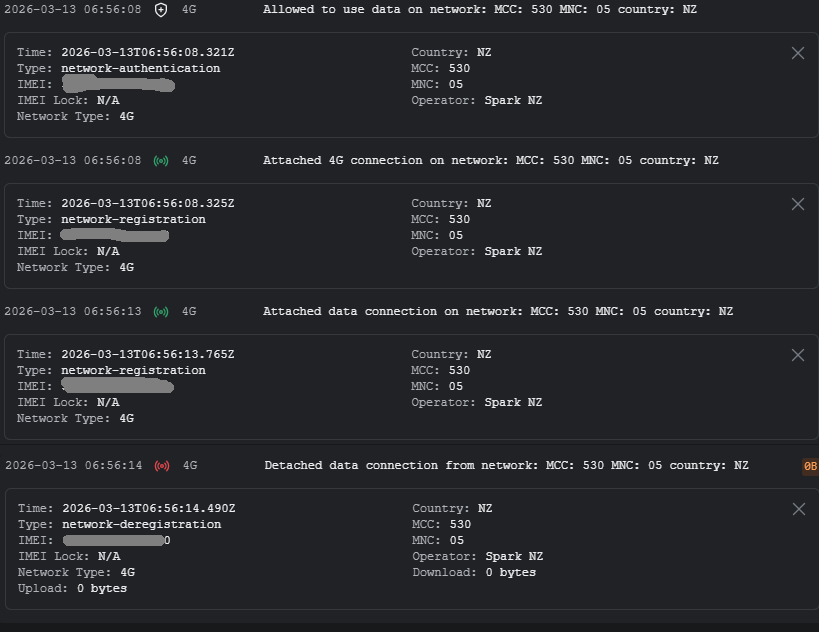

    I can see the logs in Onomondo, when I use this code with softsim:
    I've gone through the conf with a fine tooth comb, and tried a dozen different things. Why is such a dead simple peice of code failing. If I run up the multi-service example in its original form, that will work. And it uses identical code, so it must be some sutble dependency or other config issue... This ecosystem seems to be MUCH too brittle.
