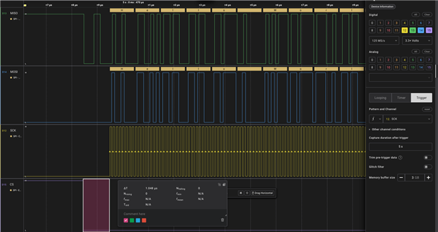

  • I finally got around to test this, but I did not manage to reproduce the issue where the SPIS is not even responding with DEF.
    Here with CSN to CLK time set to 1 us:

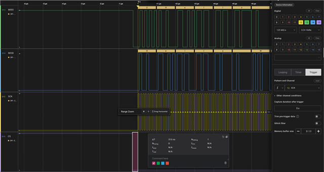

    And same at 0.3 us:

  • It should not make any difference. Which API are you using?
  • Ok thanks for confirming. I think there must be another explanation for why it is not working in your application. I still find it very strange that it works fine when the chip is in debug interface mode, but not in constant latency mode. From the cases I can recall where something worked in debug interface mode but not in low power mode, it would also work in constant latency mode. Using my test sample also confirms that the SPIS is behaving according to the specification. Suggestions for further troubleshooting: 1. Read out the peripheral registers from both projects do see if there are any differences in the configuration. 2. if possible, measure the sleep current of the nRF52840 alone to confirm that the chip stays in constant latency mode.
