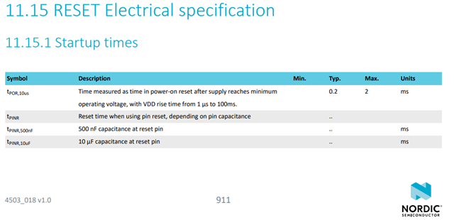

What's minimum hold time for a pin reset on nRF54L10? https://docs-be.nordicsemi.com/bundle/ps_nrf54L15/page/pdf/nRF54L15_nRF54L10_nRF54L05_Datasheet_v1.0.pdf doesn't state any type of value:

I am checking with the team and will update the case once I have gathered enough information.
Amanda H.
From the team:
You should hold nRESET low for a minimum of 2-3ms to ensure correct reset behaviour.
-Amanda H.
