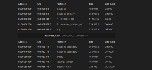

Partition Layout (external_flash)
0x00000000 - 0x000EFFFF  mcuboot_secondary
0x000F0000 - 0x0012FFFF  mcuboot_secondary_1 (previous configuration)
0x00130000 - 0x00133FFF  empty
0x00134000 - 0x00137FFF  settings_storage (16 KB)
0x00138000 - 0x003FFFFF  remaining external flash

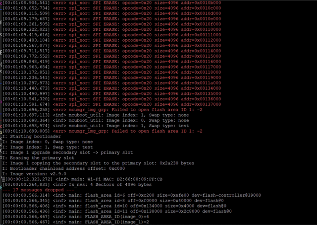

Observed Behavior
During image swap, the log shows multiple sector erase operations in the external flash region:
spi_nor: SPI ERASE opcode=0x20 size=4096 addr=0x0010D000
spi_nor: SPI ERASE opcode=0x20 size=4096 addr=0x00134000
spi_nor: SPI ERASE opcode=0x20 size=4096 addr=0x00135000
The addresses 0x00134000 and above correspond to the settings_storage partition.
After the upgrade completes, all stored settings are lost, indicating that the partition was erased as part of the swap operation.

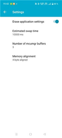

nRF Connect, 2026-03-03

D 17:43:34.375 [McuMgr] gatt.writeDescriptor(00002902-0000-1000-8000-00805f9b34fb, value=0x01-00)
I 17:43:34.561 [McuMgr] Data written to descr. 00002902-0000-1000-8000-00805f9b34fb
V 17:43:34.567 [McuMgr] Waiting for value change...
V 17:43:34.569 [McuMgr] Writing characteristic da2e7828-fbce-4e01-ae9e-261174997c48 (WRITE COMMAND)
D 17:43:34.574 [McuMgr] gatt.writeCharacteristic(da2e7828-fbce-4e01-ae9e-261174997c48, value=0x000000010000FF06A0, WRITE COMMAND)
I 17:43:34.578 [McuMgr] Data written to da2e7828-fbce-4e01-ae9e-261174997c48
I 17:43:34.661 [McuMgr] Notification received from da2e7828-fbce-4e01-ae9e-261174997c48, value: (0x) 01-00-00-19-00-00-FF-06-BF-68-62-75-66-5F-73-69-7A-65-19-09-AB-69-62-75-66-5F-63-6F-75-6E-74-04-FF
I 17:43:34.666 [McuMgr] Wait for value changed complete
A 17:43:34.670 [McuMgr] Received Header (Version: 0, Op: 1, Flags: 0, Len: 25, Group: 0, Seq: 255, Command: 6) CBOR {"buf_size":2475,"buf_count":4}
I 17:43:34.677 [McuMgr] SMP reassembly supported with buffer size: 2475 bytes and count: 4
V 17:43:34.683 [McuMgr] Requesting connection priority: HIGH (11.25–15ms, 0, 5s)...
D 17:43:34.687 [McuMgr] gatt.requestConnectionPriority(HIGH)
A 17:43:34.699 [McuMgr] Sending (9 bytes) Header (Version: 1, Op: 0, Flags: 0, Len: 1, Group: 0, Seq: 0, Command: 8) CBOR {}
V 17:43:34.894 [McuMgr] Writing characteristic da2e7828-fbce-4e01-ae9e-261174997c48 (WRITE COMMAND)
D 17:43:34.898 [McuMgr] gatt.writeCharacteristic(da2e7828-fbce-4e01-ae9e-261174997c48, value=0x0800000100000008A0, WRITE COMMAND)
I 17:43:34.902 [McuMgr] Data written to da2e7828-fbce-4e01-ae9e-261174997c48
I 17:43:35.000 [McuMgr] Notification received from da2e7828-fbce-4e01-ae9e-261174997c48, value: (0x) 09-00-00-15-00-00-00-08-BF-6A-62-6F-6F-74-6C-6F-61-64-65-72-67-4D-43-55-62-6F-6F-74-FF
A 17:43:35.004 [McuMgr] Received Header (Version: 1, Op: 1, Flags: 0, Len: 21, Group: 0, Seq: 0, Command: 8) CBOR {"bootloader":"MCUboot"}
A 17:43:35.012 [McuMgr] Sending (20 bytes) Header (Version: 1, Op: 0, Flags: 0, Len: 12, Group: 0, Seq: 1, Command: 8) CBOR {"query":"mode"}
V 17:43:35.013 [McuMgr] Writing characteristic da2e7828-fbce-4e01-ae9e-261174997c48 (WRITE COMMAND)
D 17:43:35.014 [McuMgr] gatt.writeCharacteristic(da2e7828-fbce-4e01-ae9e-261174997c48, value=0x0800000C00000108A1657175657279646D6F6465, WRITE COMMAND)
I 17:43:35.019 [McuMgr] Data written to da2e7828-fbce-4e01-ae9e-261174997c48
I 17:43:35.097 [McuMgr] Notification received from da2e7828-fbce-4e01-ae9e-261174997c48, value: (0x) 09-00-00-08-00-00-01-08-BF-64-6D-6F-64-65-02-FF
A 17:43:35.102 [McuMgr] Received Header (Version: 1, Op: 1, Flags: 0, Len: 8, Group: 0, Seq: 1, Command: 8) CBOR {"mode":2}
A 17:43:35.106 [McuMgr] Sending (9 bytes) Header (Version: 1, Op: 0, Flags: 0, Len: 1, Group: 1, Seq: 2, Command: 0) CBOR {}
V 17:43:35.107 [McuMgr] Writing characteristic da2e7828-fbce-4e01-ae9e-261174997c48 (WRITE COMMAND)
D 17:43:35.109 [McuMgr] gatt.writeCharacteristic(da2e7828-fbce-4e01-ae9e-261174997c48, value=0x0800000100010200A0, WRITE COMMAND)
I 17:43:35.112 [McuMgr] Data written to da2e7828-fbce-4e01-ae9e-261174997c48
I 17:43:35.196 [McuMgr] Notification received from da2e7828-fbce-4e01-ae9e-261174997c48, valu
e: (0x) 09-00-01-02-00-01-02-00-BF-66-69-6D-61-67-65-73-9F-BF-65-69-6D-61-67-65-00-64-73-6C-6F-74-00-67-76-65-72-73-69-6F-6E-65-32-2E-39-2E-30-64-68-61-73-68-58-20-A2-0E-1A-13-1E-AA-BA-68-59-B6-93-9E-2F-E4-B0-4C-56-38-BD-D0-27-10-A1-4B-E5-2C-CD-73-0E-92-DE-71-68-62-6F-6F-74-61-62-6C-65-F5-67-70-65-6E-64-69-6E-67-F4-69-63-6F-6E-66-69-72-6D-65-64-F5-66-61-63-74-69-76-65-F5-69-70-65-72-6D-61-6E-65-6E-74-F4-FF-BF-65-69-6D-61-67-65-00-64-73-6C-6F-74-01-67-76-65-72-73-69-6F-6E-65-32-2E-39-2E-30-64-68-61-73-68-58-20-A2-0E-1A-13-1E-AA-BA-68-59-B6-93-9E-2F-E4-B0-4C-56-38-BD-D0-27-10-A1-4B-E5-2C-CD-73-0E-92-DE-71-68-62-6F-6F-74-61-62-6C-65-F5-67-70-65-6E-64-69-6E-67-F4-69-63-6F-6E-66-69-72-6D-65-64-F4-66-61-63-74-69-76-65-F4-69-70-65-72-6D-61-6E-65-6E-74-F4-FF-FF-6B-73-70-6C-69-74-53-74-61-74-75-73-00-FF
A 17:43:35.199 [McuMgr] Received Header (Version: 1, Op: 1, Flags: 0, Len: 258, Group: 1, Seq: 2, Command: 0) CBOR {"images":[{"image":0,"slot":0,"version":"2.9.0","hash":"og4aEx6qumhZtpOeL+SwTFY4vdAnEKFL5SzNcw6S3nE=","bootable":true,"pending":false,"confirmed":true,"active":true,"permanent":false},{"image":0,"slot":1,"version":"2.9.0","hash":"og4aEx6qumhZtpOeL+SwTFY4vdAnEKFL5SzNcw6S3nE=","bootable":true,"pending":false,"confirmed":false,"active":false,"permanent":false}],"splitStatus":0}
V 17:43:35.206 [McuMgr] Uploading firmware...
I 17:43:35.639 Connection parameters updated (interval: 11.25ms, latency: 0, timeout: 420ms)
I 17:43:35.761 Connection parameters updated (interval: 15.0ms, latency: 0, timeout: 5000ms)
A 17:44:13.888 [McuMgr] 170184 bytes sent in 38350 ms (4.44 kB/s)
V 17:44:14.132 [McuMgr] New state: TEST
A 17:44:14.141 [McuMgr] Sending (57 bytes) Header (Version: 1, Op: 2, Flags: 0, Len: 49, Group: 1, Seq: 148, Command: 0) CBOR {"confirm":false,"hash":"VMoYLdTpEMZZKFcF5Vgn5/vCDvLaxJMaH+beIWnEf9Q="}
V 17:44:14.144 [McuMgr] Writing characteristic da2e7828-fbce-4e01-ae9e-261174997c48 (WRITE COMMAND)
D 17:44:14.146 [McuMgr] gatt.writeCharacteristic(da2e7828-fbce-4e01-ae9e-261174997c48, value=0x0A00003100019400A267636F6E6669726DF46468617368582054CA182DD4E910C659285705E55827E7FBC20EF2DAC4931A1FE6DE2169C47FD4, WRITE COMMAND)
I 17:44:14.154 [McuMgr] Data written to da2e7828-fbce-4e01-ae9e-261174997c48
I 17:44:14.182 [McuMgr] Notification received from da2e7828-fbce-4e01-ae9e-261174997c48, value: (0x) 0B-00-01-77-00-01-94-00-BF-66-69-6D-61-67-65-73-9F-BF-65-69-6D-61-67-65-00-64-73-6C-6F-74-00-67-76-65-72-73-69-6F-6E-65-32-2E-39-2E-30-64-68-61-73-68-58-20-A2-0E-1A-13-1E-AA-BA-68-59-B6-93-9E-2F-E4-B0-4C-56-38-BD-D0-27-10-A1-4B-E5-2C-CD-73-0E-92-DE-71-68-62-6F-6F-74-61-62-6C-65-F5-67-70-65-6E-64-69-6E-67-F4-69-63-6F-6E-66-69-72-6D-65-64-F5-66-61-63-74-69-76-65-F5-69-70-65-72-6D-61-6E-65-6E-74-F4-FF-BF-65-69-6D-61-67-65-00-64-73-6C-6F-74-01-67-76-65-72-73-69-6F-6E-65-32-2E-39-2E-30-64-68-61-73-68-58-20-54-CA-18-2D-D4-E9-10-C6-59-28-57-05-E5-58-27-E7-FB-C2-0E-F2-DA-C4-93-1A-1F-E6-DE-21-69-C4-7F-D4-68-62-6F-6F-74-61-62-6C-65-F5-67-70-65-6E-64-69-6E-67-F5-69-63-6F-6E-66-69-72-6D-65-64-F4-66-61-63-74-69-76-65-F4-69-70-65-72-6D-61-6E-65-6E-74-F4-FF-BF-65-69-6D-61-67-65-01-64-73-6C-6F-74-01-67-76-65-72-73-69-6F-6E-65-30-2E-30-2E-30-64-68-61-73-68-58-20-57-6D-7C-B9-1A-E8-ED-56-49-61-16-B1-B1-60-E1-E4-7C-F4-4E-F6-4F-1A-A6-05-D0-F8-CB-04-9A-19-B9-10-68-62-6F-6F-74-61-62-6C-65-F5-67-70-65-6E-64-69-6E-67-F4-69-63-6F-6E-66-69-72-6D-65-64-F4-66-61-63-74-69-76-65-F4-69-70-65-72-6D-61-6E-65-6E-74-F4-FF-FF-6B-73-70-6C-69-74-53-74-61-74-75-73-00-FF
A 17:44:14.186 [McuMgr] Received Header (Version: 1, Op: 3, Flags: 0, Len: 375, Group: 1, Seq: 148, Command: 0) CBOR {"images":[{"image":0,"slot":0,"version":"2.9.0","hash":"og4aEx6qumhZtpOeL+SwTFY4vdAnEKFL5SzNcw6S3nE=","bootable":true,"pending":false,"confirmed":true,"active":true,"permanent":false},{"image":0,"slot":1,"version":"2.9.0","hash":"VMoYLdTpEMZZKFcF5Vgn5/vCDvLaxJMaH+beIWnEf9Q=","bootable":true,"pending":true,"confirmed":false,"active":false,"permanent":false},{"image":1,"slot":1,"version":"0.0.0","hash":"V218uRro7VZJYRaxsWDh5Hz0TvZPGqYF0PjLBJoZuRA=","bootable":true,"pending":false,"confi
A 17:44:14.194 [McuMgr] Sending (57 bytes) Header (Version: 1, Op: 2, Flags: 0, Len: 49, Group: 1, Seq: 149, Command: 0) CBOR {"confirm":false,"hash":"V218uRro7VZJYRaxsWDh5Hz0TvZPGqYF0PjLBJoZuRA="}
V 17:44:14.198 [McuMgr] Writing characteristic da2e7828-fbce-4e01-ae9e-261174997c48 (WRITE COMMAND)
D 17:44:14.200 [McuMgr] gatt.writeCharacteristic(da2e7828-fbce-4e01-ae9e-261174997c48, value=0x0A00003100019500A267636F6E6669726DF464686173685820576D7CB91AE8ED56496116B1B160E1E47CF44EF64F1AA605D0F8CB049A19B910, WRITE COMMAND)
I 17:44:14.208 [McuMgr] Data written to da2e7828-fbce-4e01-ae9e-261174997c48
I 17:44:14.235 [McuMgr] Notification received from da2e7828-fbce-4e01-ae9e-261174997c48, value: (0x) 0B-00-01-77-00-01-95-00-BF-66-69-6D-61-67-65-73-9F-BF-65-69-6D-61-67-65-00-64-73-6C-6F-74-00-67-76-65-72-73-69-6F-6E-65-32-2E-39-2E-30-64-68-61-73-68-58-20-A2-0E-1A-13-1E-AA-BA-68-59-B6-93-9E-2F-E4-B0-4C-56-38-BD-D0-27-10-A1-4B-E5-2C-CD-73-0E-92-DE-71-68-62-6F-6F-74-61-62-6C-65-F5-67-70-65-6E-64-69-6E-67-F4-69-63-6F-6E-66-69-72-6D-65-64-F5-66-61-63-74-69-76-65-F5-69-70-65-72-6D-61-6E-65-6E-74-F4-FF-BF-65-69-6D-61-67-65-00-64-73-6C-6F-74-01-67-76-65-72-73-69-6F-6E-65-32-2E-39-2E-30-64-68-61-73-68-58-20-54-CA-18-2D-D4-E9-10-C6-59-28-57-05-E5-58-27-E7-FB-C2-0E-F2-DA-C4-93-1A-1F-E6-DE-21-69-C4-7F-D4-68-62-6F-6F-74-61-62-6C-65-F5-67-70-65-6E-64-69-6E-67-F5-69-63-6F-6E-66-69-72-6D-65-64-F4-66-61-63-74-69-76-65-F4-69-70-65-72-6D-61-6E-65-6E-74-F4-FF-BF-65-69-6D-61-67-65-01-64-73-6C-6F-74-01-67-76-65-72-73-69-6F-6E-65-30-2E-30-2E-30-64-68-61-73-68-58-20-57-6D-7C-B9-1A-E8-ED-56-49-61-16-B1-B1-60-E1-E4-7C-F4-4E-F6-4F-1A-A6-05-D0-F8-CB-04-9A-19-B9-10-68-62-6F-6F-74-61-62-6C-65-F5-67-70-65-6E-64-69-6E-67-F5-69-63-6F-6E-66-69-72-6D-65-64-F4-66-61-63-74-69-76-65-F4-69-70-65-72-6D-61-6E-65-6E-74-F4-FF-FF-6B-73-70-6C-69-74-53-74-61-74-75-73-00-FF
A 17:44:14.238 [McuMgr] Received Header (Version: 1, Op: 3, Flags: 0, Len: 375, Group: 1, Seq: 149, Command: 0) CBOR {"images":[{"image":0,"slot":0,"version":"2.9.0","hash":"og4aEx6qumhZtpOeL+SwTFY4vdAnEKFL5SzNcw6S3nE=","bootable":true,"pending":false,"confirmed":true,"active":true,"permanent":false},{"image":0,"slot":1,"version":"2.9.0","hash":"VMoYLdTpEMZZKFcF5Vgn5/vCDvLaxJMaH+beIWnEf9Q=","bootable":true,"pending":true,"confirmed":false,"active":false,"permanent":false},{"image":1,"slot":1,"version":"0.0.0","hash":"V218uRro7VZJYRaxsWDh5Hz0TvZPGqYF0PjLBJoZuRA=","bootable":true,"pending":true,"confirmed":false,"active":false,"permanent":false}],"splitStatus":0}
V 17:44:14.241 [McuMgr] New state: RESET
A 17:44:14.243 [McuMgr] Sending (9 bytes) Header (Version: 1, Op: 2, Flags: 0, Len: 1, Group: 0, Seq: 150, Command: 5) CBOR {}
V 17:44:14.245 [McuMgr] Writing characteristic da2e7828-fbce-4e01-ae9e-261174997c48 (WRITE COMMAND)
D 17:44:14.245 [McuMgr] gatt.writeCharacteristic(da2e7828-fbce-4e01-ae9e-261174997c48, value=0x0A00000100009605A0, WRITE COMMAND)
I 17:44:14.253 [McuMgr] Data written to da2e7828-fbce-4e01-ae9e-261174997c48
I 17:44:14.278 [McuMgr] Notification received from da2e7828-fbce-4e01-ae9e-261174997c48, value: (0x) 0B-00-00-02-00-00-96-05-BF-FF
A 17:44:14.282 [McuMgr] Received Header (Version: 1, Op: 3, Flags: 0, Len: 2, Group: 0, Seq: 150, Command: 5) CBOR {}
D 17:44:19.508 [Callback] Connection state changed with status: 8 and new state: DISCONNECTED (0)
D 17:44:19.509 [McuMgr] [Callback] Connection state changed with status: 8 and new state: 0 (DISCONNECTED)
E 17:44:19.509 Error 8 (0x8): GATT CONN TIMEOUT
I 17:44:19.509 Disconnected
W 17:44:19.516 [McuMgr] Error: (0x8): GATT CONN TIMEOUT
I 17:44:19.519 [McuMgr] Disconnected
D 17:44:19.536 [McuMgr] gatt.close()
D 17:44:19.542 [Broadcast] Action received: android.bluetooth.device.action.ACL_DISCONNECTED
V 17:44:24.293 [McuMgr] Connecting...
D 17:44:24.301 [McuMgr] gatt = device.connectGatt(autoConnect = false, TRANSPORT_LE, LE 1M)
V 17:44:24.307 [McuMgr] New state: CONFIRM
D 17:44:34.322 [McuMgr] [Callback] Connection state changed with status: 147 and new state: 0 (DISCONNECTED)
W
17:44:34.325 [McuMgr] Error: (0x93): UNKNOWN (147)
D 17:44:34.328 [McuMgr] wait(500)
D 17:44:34.831 [McuMgr] gatt.close()
D 17:44:34.842 [McuMgr] wait(200)
V 17:44:35.053 [McuMgr] Retrying...
D 17:44:35.057 [McuMgr] gatt = device.connectGatt(autoConnect = false, TRANSPORT_LE, LE 1M)
D 17:44:45.088 [McuMgr] [Callback] Connection state changed with status: 147 and new state: 0 (DISCONNECTED)
W 17:44:45.092 [McuMgr] Error: (0x93): UNKNOWN (147)
D 17:44:45.094 [McuMgr] wait(500)
D 17:44:45.596 [McuMgr] gatt.close()
D 17:44:45.604 [McuMgr] wait(200)
V 17:44:45.810 [McuMgr] Retrying...
D 17:44:45.815 [McuMgr] gatt = device.connectGatt(autoConnect = false, TRANSPORT_LE, LE 1M)
D 17:44:55.847 [McuMgr] [Callback] Connection state changed with status: 147 and new state: 0 (DISCONNECTED)
W 17:44:55.851 [McuMgr] Error: (0x93): UNKNOWN (147)
D 17:44:55.854 [McuMgr] wait(500)
D 17:44:56.357 [McuMgr] gatt.close()
D 17:44:56.369 [McuMgr] wait(200)
V 17:44:56.577 [McuMgr] Retrying...
D 17:44:56.583 [McuMgr] gatt = device.connectGatt(autoConnect = false, TRANSPORT_LE, LE 1M)
D 17:44:58.437 [McuMgr] [Callback] Connection state changed with status: 0 and new state: 2 (CONNECTED)
I 17:44:58.442 [McuMgr] Connected to D2:3C:E2:70:26:F1
D 17:44:58.443 [McuMgr] wait(300)
D 17:44:58.445 [Broadcast] Action received: android.bluetooth.device.action.ACL_CONNECTED
V 17:44:58.746 [McuMgr] Discovering services...
D 17:44:58.751 [McuMgr] gatt.discoverServices()
I 17:44:58.760 [McuMgr] Services discovered
V 17:44:58.764 [McuMgr] Primary service found
V 17:44:58.767 [McuMgr] Requesting new MTU...
D 17:44:58.770 [McuMgr] gatt.requestMtu(498)
I 17:44:58.885 [McuMgr] MTU changed to: 498
D 17:44:58.890 [McuMgr] gatt.setCharacteristicNotification(da2e7828-fbce-4e01-ae9e-261174997c48, true)
V 17:44:58.895 [McuMgr] Enabling notifications for da2e7828-fbce-4e01-ae9e-261174997c48
D 17:44:58.897 [McuMgr] gatt.writeDescriptor(00002902-0000-1000-8000-00805f9b34fb, value=0x01-00)
I 17:44:58.980 [McuMgr] Data written to descr. 00002902-0000-1000-8000-00805f9b34fb
V 17:44:58.983 [McuMgr] Waiting for value change...
V 17:44:58.986 [McuMgr] Writing characteristic da2e7828-fbce-4e01-ae9e-261174997c48 (WRITE COMMAND)
D 17:44:58.987 [McuMgr] gatt.writeCharacteristic(da2e7828-fbce-4e01-ae9e-261174997c48, value=0x000000010000FF06A0, WRITE COMMAND)
I 17:44:58.991 [McuMgr] Data written to da2e7828-fbce-4e01-ae9e-261174997c48
I 17:44:59.128 [McuMgr] PHY updated (TX: LE 2M, RX: LE 2M)
I 17:44:59.132 [McuMgr] Notification received from da2e7828-fbce-4e01-ae9e-261174997c48, value: (0x) 01-00-00-19-00-00-FF-06-BF-68-62-75-66-5F-73-69-7A-65-19-09-AB-69-62-75-66-5F-63-6F-75-6E-74-04-FF
I 17:44:59.133 [McuMgr] Wait for value changed complete
A 17:44:59.136 [McuMgr] Received Header (Version: 0, Op: 1, Flags: 0, Len: 25, Group: 0, Seq: 255, Command: 6) CBOR {"buf_size":2475,"buf_count":4}
I 17:44:59.143 [McuMgr] SMP reassembly supported with buffer size: 2475 bytes and count: 4
A 17:44:59.146 [McuMgr] Sending (57 bytes) Header (Version: 1, Op: 2, Flags: 0, Len: 49, Group: 1, Seq: 0, Command: 0) CBOR {"confirm":true,"hash":"VMoYLdTpEMZZKFcF5Vgn5/vCDvLaxJMaH+beIWnEf9Q="}
V 17:44:59.148 [McuMgr] Writing characteristic da2e7828-fbce-4e01-ae9e-261174997c48 (WRITE COMMAND)
D 17:44:59.149 [McuMgr] gatt.writeCharacteristic(da2e7828-fbce-4e01-ae9e-261174997c48, value=0x0A00003100010000A267636F6E6669726DF56468617368582054CA182DD4E910C659285705E55827E7FBC20EF2DAC4931A1FE6DE2169C47FD4, WRITE COMMAND)
I 17:44:59.153 [McuMgr] Data written to da2e7828-fbce-4e01-ae9e-261174997c48
I 17:44:59.372 [McuMgr] Notification received from da2e7828-fbce-4e01-ae9e-261174997c48, value: (0x) 0B-00-00-8D-00-01-00-00-BF-66-69-6D-61-67-65-73-9F-BF-65-69-6D-61-67-65-00-64-73-6C-6F-74-00-67-76-65-72-73-69-6F-6E-65-32-2E-39-2E-30-64-68-61-73-68-58-20-54-CA-18-2D-D4-E9-10-C6-59-28-57-05-E5-58-27-E7-FB-C2-0E-F2-DA-C4-93-1A-1F-E6-DE-21-69-C4-7F-D4-68-62-6F-6F-74-61-62-6C-65-F5-67-70-65-6E-64-69-6E-67-F4-69-63-6F-6E-66-69-72-6D-65-64-F5-66-61-63-74-69-76-65-F5-69-70-65-72-6D-61-6E-65-6E-74-F4-FF-FF-6B-73-70-6C-69-74-53-74-61-
74-75-73-00-FF
A 17:44:59.378 [McuMgr] Received Header (Version: 1, Op: 3, Flags: 0, Len: 141, Group: 1, Seq: 0, Command: 0) CBOR {"images":[{"image":0,"slot":0,"version":"2.9.0","hash":"VMoYLdTpEMZZKFcF5Vgn5/vCDvLaxJMaH+beIWnEf9Q=","bootable":true,"pending":false,"confirmed":true,"active":true,"permanent":false}],"splitStatus":0}
A 17:44:59.389 [McuMgr] Sending (57 bytes) Header (Version: 1, Op: 2, Flags: 0, Len: 49, Group: 1, Seq: 1, Command: 0) CBOR {"confirm":true,"hash":"V218uRro7VZJYRaxsWDh5Hz0TvZPGqYF0PjLBJoZuRA="}
V 17:44:59.395 [McuMgr] Writing characteristic da2e7828-fbce-4e01-ae9e-261174997c48 (WRITE COMMAND)
D 17:44:59.396 [McuMgr] gatt.writeCharacteristic(da2e7828-fbce-4e01-ae9e-261174997c48, value=0x0A00003100010100A267636F6E6669726DF564686173685820576D7CB91AE8ED56496116B1B160E1E47CF44EF64F1AA605D0F8CB049A19B910, WRITE COMMAND)
I 17:44:59.403 [McuMgr] Data written to da2e7828-fbce-4e01-ae9e-261174997c48
I 17:44:59.468 [McuMgr] Notification received from da2e7828-fbce-4e01-ae9e-261174997c48, value: (0x) 0B-00-00-13-00-01-01-00-BF-63-65-72-72-BF-65-67-72-6F-75-70-01-62-72-63-08-FF-FF
A 17:44:59.472 [McuMgr] Received Header (Version: 1, Op: 3, Flags: 0, Len: 19, Group: 1, Seq: 1, Command: 0) CBOR {"err":{"group":1,"rc":8}}
V 17:44:59.484 [McuMgr] Disconnecting...
D 17:44:59.487 [McuMgr] gatt.disconnect()
D 17:44:59.508 [McuMgr] [Callback] Connection state changed with status: 0 and new state: 0 (DISCONNECTED)
I 17:44:59.512 [McuMgr] Disconnected
D 17:44:59.515 [McuMgr] gatt.close()
D 17:44:59.524 gatt.close()
D 17:44:59.527 wait(200)
V 17:44:59.728 Connecting to D2:3C:E2:70:26:F1...
D 17:44:59.728 gatt = device.connectGatt(autoConnect = false, TRANSPORT_LE, preferred PHY = LE 1M)
D 17:44:59.748 [Callback] Connection state changed with status: 0 and new state: CONNECTED (2)
I 17:44:59.748 Connected to D2:3C:E2:70:26:F1
V 17:44:59.813 Discovering services...
D 17:44:59.813 gatt.discoverServices()
D 17:44:59.867 [Callback] Services discovered with status: 0
I 17:44:59.867 Services discovered
V 17:44:59.875 Generic Attribute (0x1801)
- Service Changed [I] (0x2A05)
   Client Characteristic Configuration (0x2902)
- Client Supported Features [R W] (0x2B29)
- Database Hash [R] (0x2B2A)
Generic Access (0x1800)
- Device Name [R] (0x2A00)
- Appearance [R] (0x2A01)
- Peripheral Preferred Connection Parameters [R] (0x2A04)
SMP Service (8d53dc1d-1db7-4cd3-868b-8a527460aa84)
- SMP Characteristic [N WNR] (da2e7828-fbce-4e01-ae9e-261174997c48)
Unknown Service (00008100-0000-1000-8000-00805f9b34fb)
- Unknown Characteristic [R W] (00008101-0000-1000-8000-00805f9b34fb)
- Unknown Characteristic [R W] (00008102-0000-1000-8000-00805f9b34fb)
- Unknown Characteristic [R W] (00008103-0000-1000-8000-00805f9b34fb)
- Unknown Characteristic [R W] (00008104-0000-1000-8000-00805f9b34fb)
- Unknown Characteristic [R W] (00008105-0000-1000-8000-00805f9b34fb)
- Unknown Characteristic [R W] (00008106-0000-1000-8000-00805f9b34fb)
- Unknown Characteristic [R W] (00008107-0000-1000-8000-00805f9b34fb)
- Unknown Characteristic [R W] (00008108-0000-1000-8000-00805f9b34fb)
Unknown Service (00008300-0000-1000-8000-00805f9b34fb)
- Unknown Characteristic [R W] (00008301-0000-1000-8000-00805f9b34fb)
- Unknown Characteristic [R W] (00008302-0000-1000-8000-00805f9b34fb)
- Unknown Characteristic [R W] (00008303-0000-1000-8000-00805f9b34fb)
- Unknown Characteristic [R W] (00008304-0000-1000-8000-00805f9b34fb)
- Unknown Characteristic [R W] (00008305-0000-1000-8000-00805f9b34fb)
- Unknown Characteristic [R W] (00008306-0000-1000-8000-00805f9b34fb)
- Unknown Characteristic [R W] (00008307-0000-1000-8000-00805f9b34fb)
- Unknown Characteristic [R W] (00008308-0000-1000-8000-00805f9b34fb)
- Unknown Characteristic [R W] (00008309-0000-1000-8000-00805f9b34fb)
- Unknown Characteristic [R W] (0000830a-0000-1000-8000-00805f9b34fb)
- Unknown Characteristic [R W] (0000830b-0000-1000-8000-00805f9b34fb)
- Unknown Characteristic [R W] (0000830c-0000-1000-8000-00805f9b34fb)
- Unknown Characteristic [R W] (0000830d-0000-1000-8000-
- Unknown Characteristic [R W] (0000830e-0000-1000-8000-00805f9b34fb)
- Unknown Characteristic [R W] (0000830f-0000-1000-8000-00805f9b34fb)
- Unknown Characteristic [R W] (00008310-0000-1000-8000-00805f9b34fb)
- Unknown Characteristic [R W] (00008311-0000-1000-8000-00805f9b34fb)
- Unknown Characteristic [R W] (00008312-0000-1000-8000-00805f9b34fb)
- Unknown Characteristic [R W] (00008313-0000-1000-8000-00805f9b34fb)
- Unknown Characteristic [R W] (00008314-0000-1000-8000-00805f9b34fb)
- Unknown Characteristic [R W] (00008315-0000-1000-8000-00805f9b34fb)
- Unknown Characteristic [R W] (00008316-0000-1000-8000-00805f9b34fb)
- Unknown Characteristic [W] (000083ff-0000-1000-8000-00805f9b34fb)
Unknown Service (00008200-0000-1000-8000-00805f9b34fb)
- Unknown Characteristic [R] (00008201-0000-1000-8000-00805f9b34fb)
- Unknown Characteristic [R] (00008202-0000-1000-8000-00805f9b34fb)
- Unknown Characteristic [R] (00008203-0000-1000-8000-00805f9b34fb)
- Unknown Characteristic [R] (00008204-0000-1000-8000-00805f9b34fb)
- Unknown Characteristic [R] (00008205-0000-1000-8000-00805f9b34fb)
- Unknown Characteristic [R] (00008206-0000-1000-8000-00805f9b34fb)
- Unknown Characteristic [R] (00008207-0000-1000-8000-00805f9b34fb)
D 17:44:59.875 gatt.setCharacteristicNotification(00002a05-0000-1000-8000-00805f9b34fb, true)
I 17:45:04.008 Connection parameters updated (interval: 11.25ms, latency: 0, timeout: 420ms)
I 17:45:04.853 Connection parameters updated (interval: 48.75ms, latency: 0, timeout: 420ms)
Expected Behavior
settings_storage should remain intact during firmware upgrades and not be erased as part of the MCUboot swap process.
Questions
  1. Is MCUboot expected to erase the entire external flash region during swap when secondary slot resides there?
  2. Is this caused by incorrect partition boundaries or overlap with swap/scratch areas?
  3. Should settings_storage be moved outside of the secondary slot region (e.g., to the end of flash)?
  4. Is there a recommended partition layout to protect settings in external flash when using MCUboot swap?
I would appreciate guidance on the correct configuration to ensure settings_storage is not affected by firmware updates.
