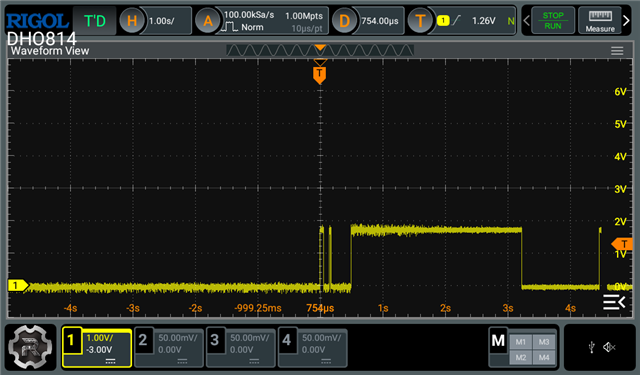

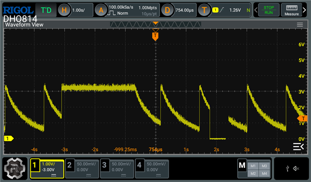

UPDATE:
I measured the supply voltage of the LNA (U9) at TP8:
And the COEX2 signal enabling the power supply of the LNA at TP22:
Thus I conclude, that LNA is working properly.
