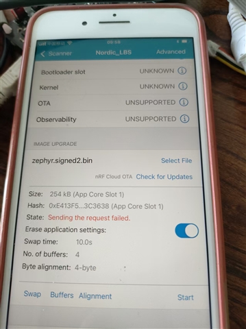

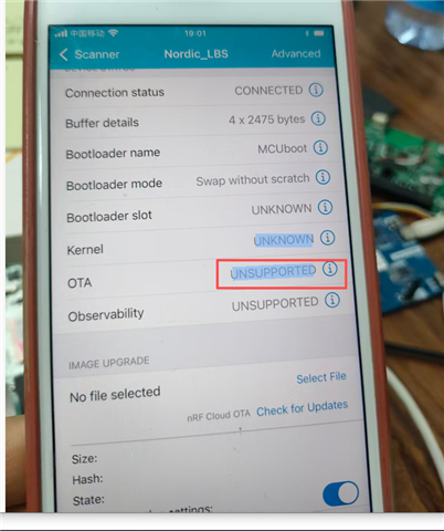

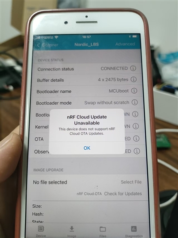

DK: nRF54L15-DK
SDK: v3.1.0
APP: nRF Connect Device Manager app (IOS)
routine: C:\ncs\v3.1.0\nrf\samples\bluetooth\peripheral_lbs
I made the modifications according to the official tutorial, but the following problems occurred.

I have tried the peripheral_lbs sample from NCS as same version as yours. It works perfectly here. Looking at the screenshot, I thinl FOTA is not fully enabled.
You can try to run the solution sample directly from the devacademy and see if it works?

You have already followed this guideline Exercise 5 - FOTA over Bluetooth Low Energy - Nordic Developer Academy I meant to run the sample from the solution in git.
