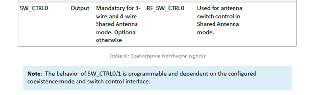

using ncs 3.1.1 how can we invert SW_CTRL0 logic we using a different RF SWITCH then DK
"Does register 0xA4002DC8 (SLEEP_CTRL_GPIO_CTRL) on nRF7002 have a bit to invert the SW_CTRL0 output polarity? We need SW_CTRL0=1 for BLE path, SW_CTRL0=0 for Wi-Fi path."
is this correct ?

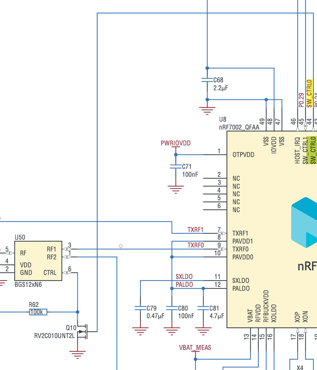

    I am sorry that our documentation is misleading. I will report this back to the wifi team.
    Yaniv933 said:
    do you have any plans in future FW to support this function?
    There are no current plans for this, as inverting the signal will cause issues if the nRF7002 is powered off (ie. BUCKEN=0). Keeping this signal high when nRF7002 is powered off will cause back-powering, therefore it is recommended that you invert the signal via a transistor instead.
