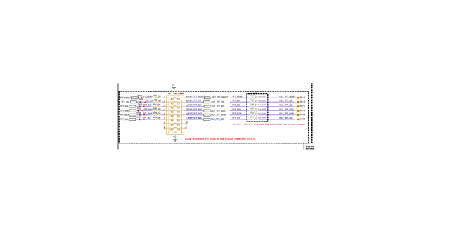

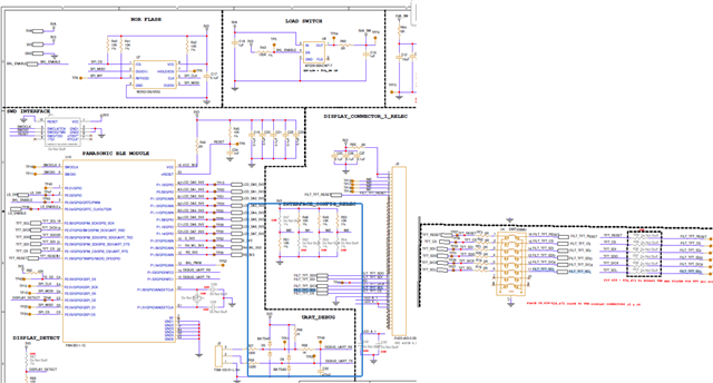

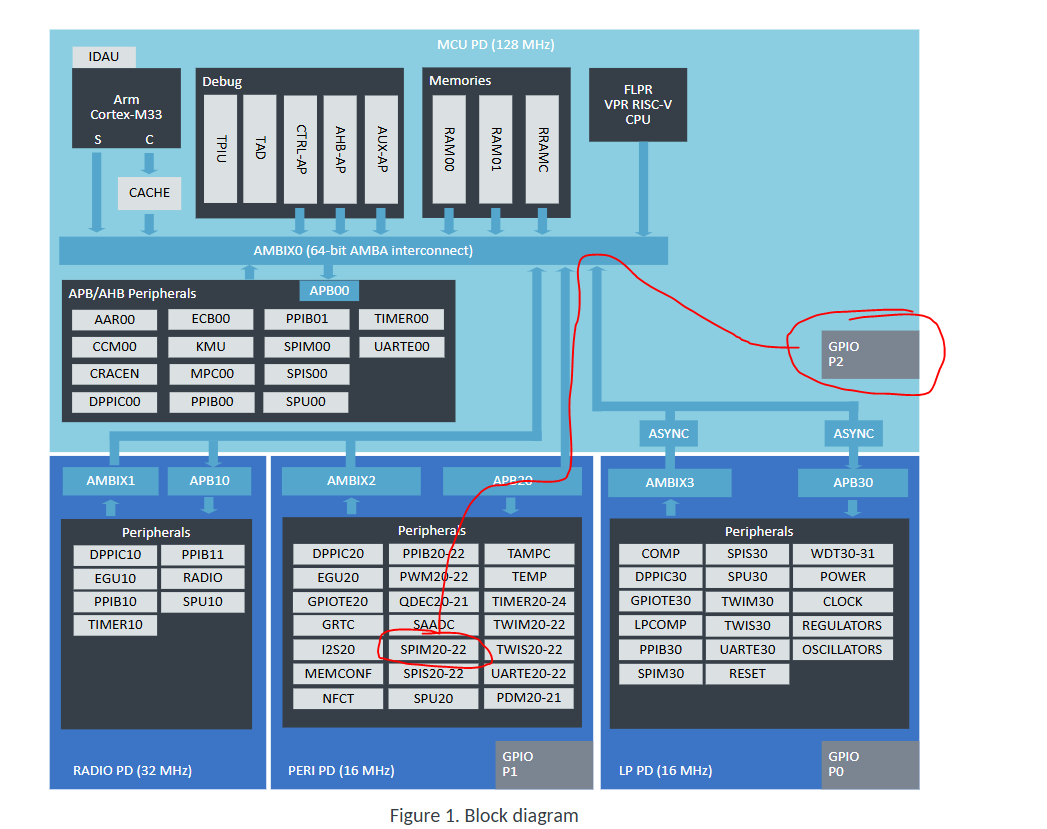

ST7789V based Display is getting corrupted with nrf54l15
I am using the nRF54L15 (PANB511 Module ) controller with an ST7789V-based display connected via SPI21 at 8 MHz. Image bin files are stored using LittleFS in external flash(W25Q128) at SPI00 at 32 MHz crystal.
The display shows images correctly if I include LOG_DBG() calls at 4 places inside the display draw function. However, if I remove those LOG_DBG() calls, the display becomes corrupted. Can you help with this, please?
.dtsi file

    one thing I can tell you is during display corruption , spi clock driven by sitronics st7789v Zephyr's display driver, is unstable so display understands it wrong and shows corrupted images in the screen.
    under Debug mode using jlink, it works well .
    i have given the schematic for reference
    those spi pins are going through filters
    You have used pin P2.10 for SPI21, so you have crossed the power domain
    You can try adding  CONFIG_NRFX_POWER=y to prj.conf and enable constant latency (before you start using SPI21/dispaly in the beginning of main() function) using nrf_sys_event_request_global_constlat(); source:nRF54L pin mapping
