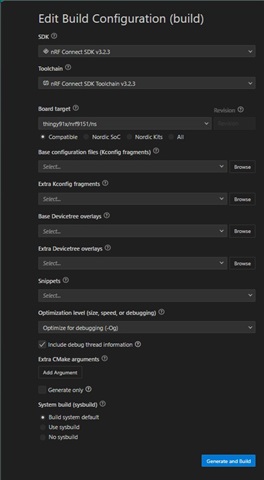

Debug build
I created a copy of the nRF Cloud CoAP Device Message sample application for the Thingy 91 X.  It builds using the default optimization level.  However it fails to build when I select "Optimize for debugging (-Og)".
The tfm_s section is too small for the generated code.
Here is a copy of the build output.
-- Build files have been written to: D:/Work/nrf_cloud_coap_device_message/build/nrf_cloud_coap_device_message/tfm
[17/493] Performing build step for 'tfm'
[149/153] Linking C executable bin\tfm_s.axf
FAILED: bin/tfm_s.axf

Memory region         Used Size  Region Size  %age Used
           FLASH:       64492 B      32256 B    199.94%
             RAM:       14560 B        16 KB     88.87%
I tried copying partitions.yml from the build folder to the root folder and modified to increase the tfm section.  Unfortunately the build process does not seem to recognize the memory map.
I tried naming it pm.yml and pm_static.yml.
Neither seem to be accepted.
Here is the options selected for the build configuration.
Here is the generated partitions.yml file.

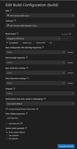

Can someone help me work this out?
    Assuming the intention is not to debug TF-M, I would recommend anohther approach, where you only build the application itself with debug optimization, and not TF-M (or other images). The most straight forward way to do this is as explained in this post. When using the nRF Cloud CoAP device message sample and using a build folder called "build", the path to the file you should edit is nrf/samples/cellular/nrf_cloud_coap_device_message/build/nrf_cloud_coap_device_message/zephyr/.config.
  • Your assumption is correct.

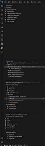

    I added the following line to the prj.conf file in the projects root folder
    CONFIG_SIZE_OPTIMIZATIONS=y
    Regarding
    "One way around this is to configure your project with CONFIG_SIZE_OPTIMIZATIONS, and afterwards go into menuconfig and change the application's optimization level. "
    where do I find menuconfig?
    I do not see a build option in "nRF Kconfig GUI" for app optimization level.
    You can start menuconfig using for instance "west build -t menuconfig". But I would recommend editing the file manually, as explained in the end of the other post. To be clear that means opening the .config file and doing the following changes:
    1. Search in the file for "CONFIG_SIZE_OPTIMIZATION" and comment out that line by adding # in front
    2. Search for "CONFIG_DEBUG_OPTIMIZATIONS" and remove the # in front (uncomment) and add =y so that it is enabled.
    Then rebuild the project.
    Now you will have debug optimization for the application itself, but not for other images (such as TF-M).
  • nrf_cloud_coap_device_message\build\zephyr\.config
    does not contain a line with CONFIG_SIZE_OPTIMIZATION or a line with CONFIG_DEBUG_OPTIMIZATIONS
    adding a line to the file results in the edits being lost when I make the build.
    That is odd. I tested this on my end just now. Can you share the full path and show the content of the file? Also, which SDK version are you using and how do you build (the path may need to be adjusted, the point is that it should be the full .config for the application). When I build the sample, I get this .config generated:
