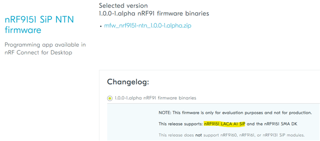

Is NTN available on nrf9151 A0A version silicon?
I am struggling to get our device configured for NTN communications with SatelIot and Skylo.
Does the version of our silicon support NTN? We are on NRF9151 LACA A0 and I can see in the documentation and in the nRF9151 SMA DK the version maybe later?
In particular, I have ntn_1.0.0-1.alpha firmware programmed but the at%xsystemmode=0,0,0,0,1 and the band lock do not seem to be accepted.
%HWVERSION: nRF9151 LACA A0A
