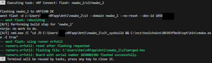

The ironic part is that flashing the firmware still works successfully, even though the device ID isn't recognized correctly.

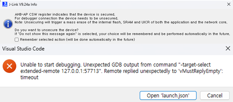

However, when I attempt to start debugging, I encounter the following error:
I suspect that the Application Core is protected (APPROTECT), which prevents the debugger from correctly identifying the nRF5340 IC on my custom board.

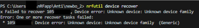

I tried to perform a recovery to resolve this, but the recovery process also fails with the following error:
How can I get the debugger to correctly recognize the device as NRF5340_xxAA_REV1 again instead of "Unknown device"?

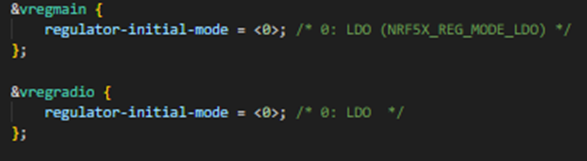

  • Your overlay is correct, so if it is being applied it should not be an issue with the regulator settings. If you want to confirm that it is being applied, you can check the final DT configuration in the zephyr.dts file generated for your application in the build folder. You can also try to read the regulator registers with nrfutil (if it doesn't fail to connect).
