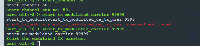

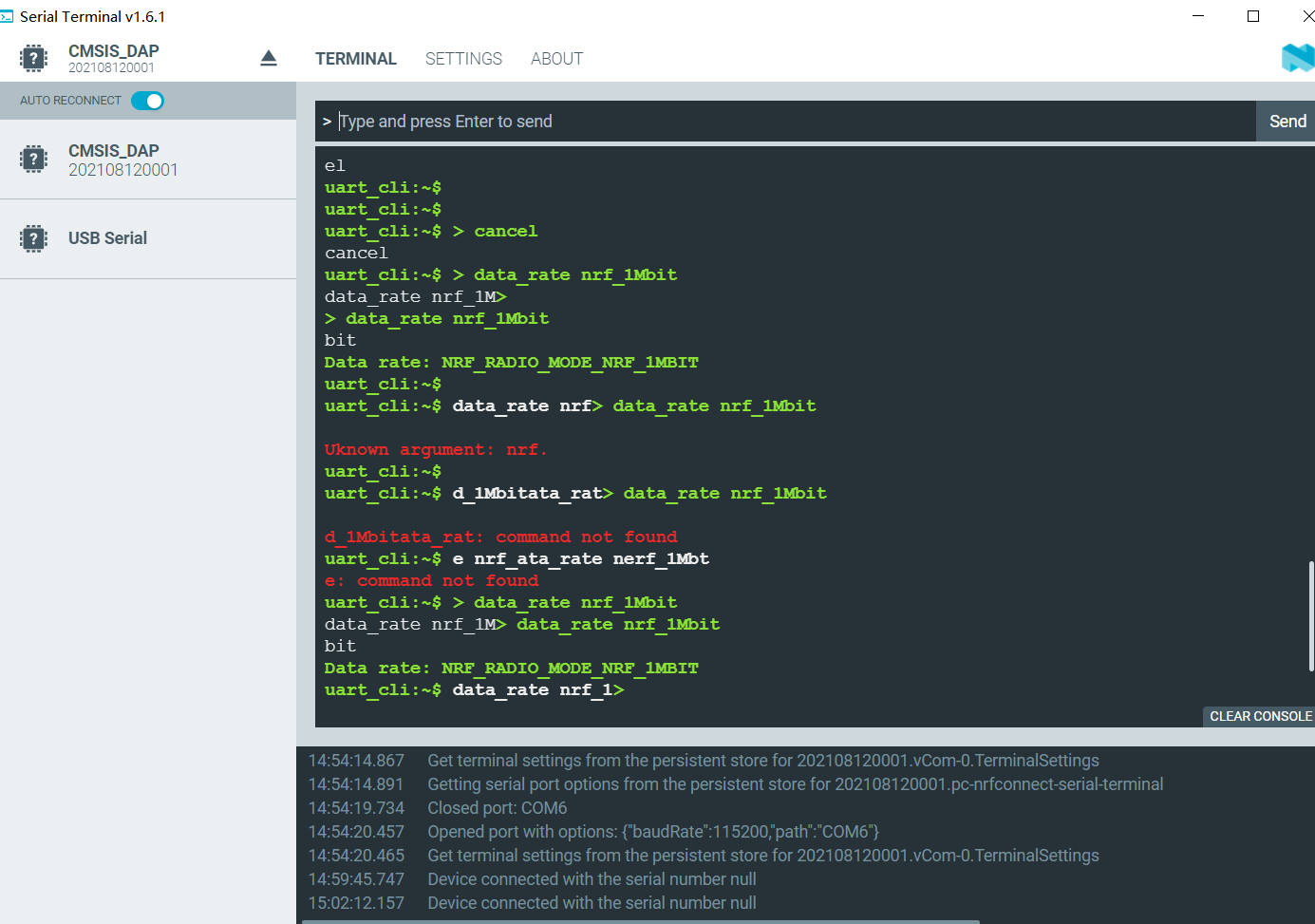

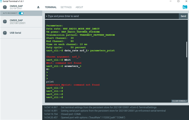

I am trying to use radio test to do FCC, but when I test the example, I found some issues.
When I test it by nRF connect the input may be truncated or pieced together.
see the images
here is my cmd
data_rate nrf_1Mbit
output_power pos4dBm
transmit_pattern pattern_random
start_channel 30
parameters_print
start_tx_modulated_carrier
start_rx
print_rx
cancel
and I did more test, it looks when input this two cmd, it always wrong
"parameters_print"
"start_tx_modulated_carrier"
 it looks when no para after cmd then easy get error.
e.g. When I use " start_tx_modulated_carrier 99999" it works good, but when I only use "start_tx_modulated_carrier" then it will wrong.
and sometimes it parse wrong cmd
Hope you can help me about this issue.
