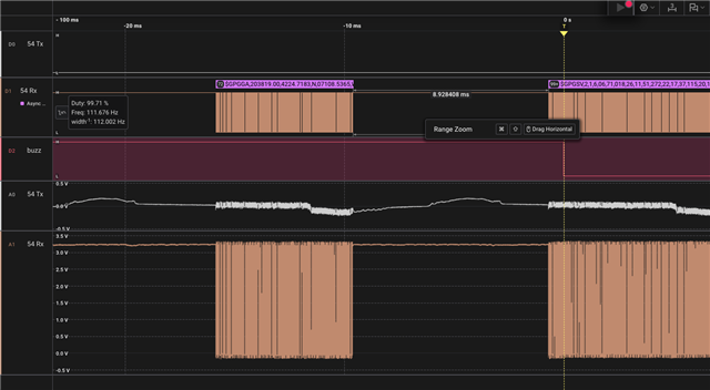

Key observation: the event tends to happen right when there is an 8-10ms ms idle gap between two RX message bursts (NMEA sentences). Long continuous streams (no gap) can run indefinitely without errors. So this doesn't seem like clock drift See images below.

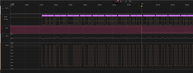

We captured the UART around the failure with a logic analyzer triggered by a GPIO that toggles when we detect UART_RX_STOPPED. UART waveform and decoded bytes look normal around the trigger point (no visible line glitches, clean start/stop bits at 115200). Despite that, the driver reports reason=4.
Error happens 8 bytes in:
There was another NMEA message that ended 8.9ms before. Start of pervious message to when the error happens is 15ms.

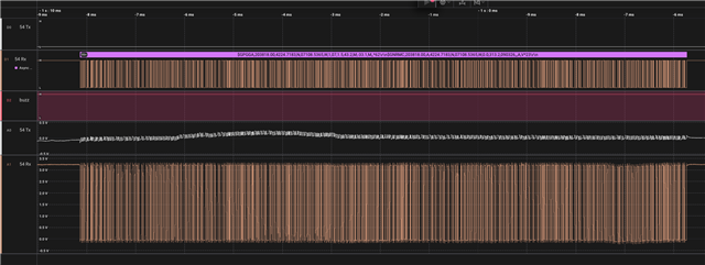

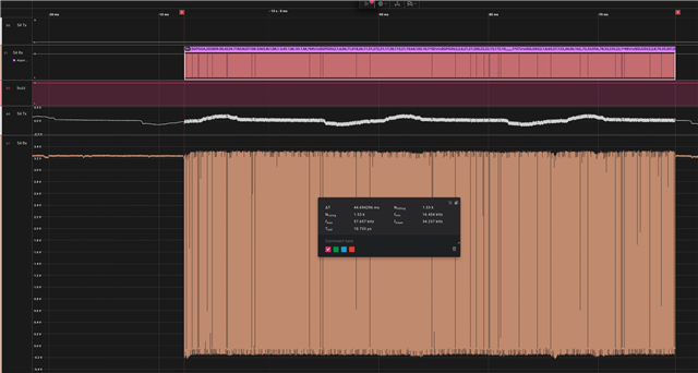

This trace was a whole second earlier and it shows successfully processing many bytes without errors. It includes 2 successive NMEA messages.

  • Confirmed the failure correlates with 8-10 ms idle gaps (we've seen 8.5ms, 9.5ms, 9.2ms); longer continuous streams do not show errors.
