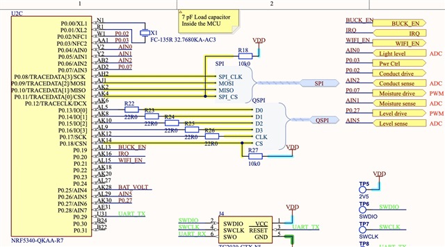

We have built a custom PCB with an nRF5340 and an nRF7002Q Wi-Fi module. I have attached the relevant schematics for the PCB.
We are using the nRF SDK v3.1.1 and are experiencing Wi-Fi issues on approximately half of our devices.
On devices that exhibit the problem, the system is able to initialize the Wi-Fi module and perform a Wi-Fi scan, but when a second Wi-Fi scan is initiated, the Wi-Fi module stops responding.

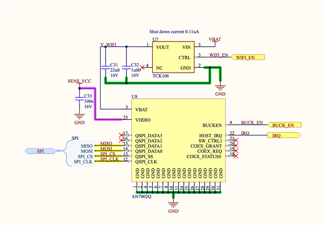

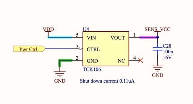

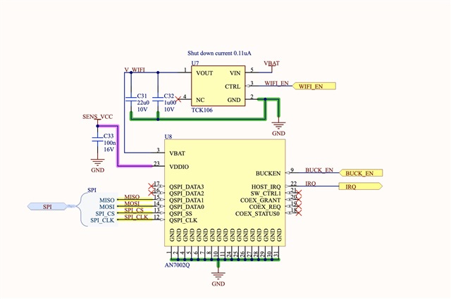

On our custom board, VBAT to the Wi-Fi module is controlled by a load switch, which is configured with:
supply-gpios = <&gpio0 21 (GPIO_ACTIVE_HIGH)>;
According to the documentation for the nRF7002 device driver, setting this in the device tree should be sufficient:
https://docs.zephyrproject.org/4.2.0/build/dts/api/bindings/wifi/nordic%2Cnrf7002-spi.html
However, when reading the driver source, the driver does not actually handle this pin. I have therefore added support for it myself in `rpu_hw_if.c`. I have attached the file in which I made the patch.
With this patch, the device is able to initialize the Wi-Fi module.

| Brownout | I have verified the power supply with an oscilloscope on both VBAT and IOVDD. The voltage is stable at 3.6V on VBAT and 2.5V on IOVDD.|
