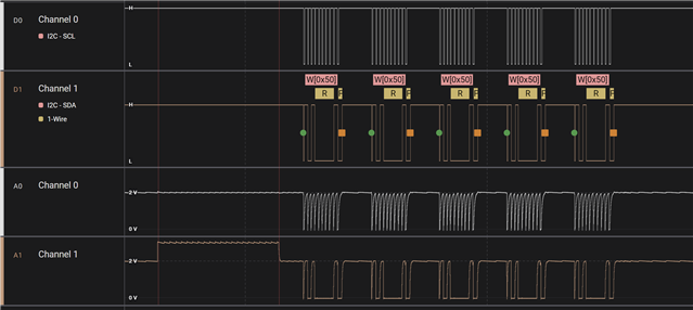

I am running into an issue when trying to use both GPIO and I2C peripherals on the same set of pins on an nRF54L15 board. I have an I2C bus configured on two pins, and can see the I2C traffic on that bus working as expected. However, at times when I2C is not in use, our application needs to use basic GPIO functionality to set the value of those same pins, and seems to be unable to do so. Just as a proof of concept, I have our application configuring the pins as output using gpio_pin_configure_dt and then toggling the pins on and off twice prior to attempting the I2C transaction. The I2C operations still works, but the toggling does not seem to be occurring on the pins.
For the period when the signals are reconfigured as push-pull outputs, it seems like the signals are being driven high, but no toggling occurs. Once the bus is used for I2C again, it is configured open-drain and is no longer being driven high, which is expected.
When I change the I2C bus pin definitions to use different pins, the GPIO toggling occurs as expected, which confirms that the GPIO pin definitions and application logic are working by themselves. We are using NCS version 3.2.1.
Is there something specific we would need to do to 'disable' I2C control of these pins when we are expecting to use GPIO control instead?

Regardless of whether the output configuration sets the GPIO_OUTPUT_LOW, OUTPUT_HIGH, or OUPUT_ACTIVE flags, the results on the scope is always just driving a HIGH voltage, and never LOW.
Here is what we're seeing on the scope when trying to toggle pin 12. There is the 5ms period in the beginning between the red markers when the pin has been reconfigured as push-pull output, but no toggling occurs. It is then reconfigured to open-drain and the I2C operation occurs as expected (no device is connected on the bus). The bus pull-up voltage is only 2V due to weak external pullups. That should not impact the GPIO toggling behavior, but it does allow us to see the difference between push-pull and pull-up logic HIGHs.

  • Hi Vidar,
    Thank you for your response, we were able to get that working!
    I had a bit of confusion as to which device struct we needed to be referring as the i2c_dev with these pm_device function calls. I found that it was working when providing the pointer to the I2C bus node itself, and not the nodes for the clients on the bus (ex the EEPROM or sensor chips we're talking to). But with that straightened out, this seems to be working as expected.
    Thanks again
