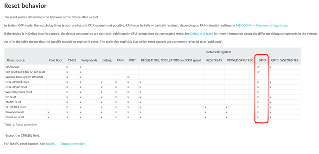

    nRF54L15 does support GPIO retention, but you need to enable it using the retention API, see nrf_gpio_pin_retain_enable.
    That said, I’m not sure if the GPIO state will survive the reset that happens during FOTA, since that process involves a system reset and the behavior can depend on the reset type. I’ll double-check this and get back to you.

    GPIO configs are  only retained through a system off reset. For other reset sources they are cleared. So after the OTA update and reboot, the GPIO returning to its default/reset state is the expected behavior. Could you give some more context on what exactly is the use case here? See the section reset behavior.
    Kind Regards,
    Abhijith

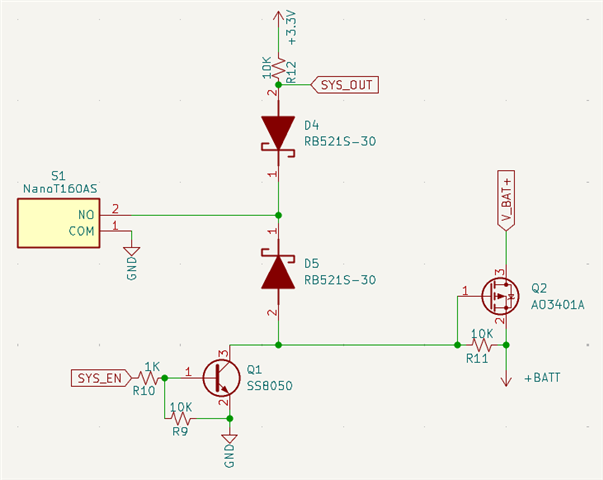

  • Hello Abhijith,
    Thank you for the clarification.
    In our design, P1.06 (SYS_EN) is used as the power enable pin. It is initially set high to keep the system powered on. If this pin goes low, the system powers off.
    We also have a power button in the circuit. The firmware detects the button press by reading P1.05 (SYS_OUT) and then toggles P1.06 (SYS_EN) to control the system power.
    However, after performing FOTA, the device reboots and the state of P1.06 returns to its default value. As a result, SYS_EN becomes low and the system powers off. The device can only power on again when the button is pressed manually to power up the controller.
    I have attached the relevant part of the schematic for reference.
    Jishnu K J
    In this case, I don’t think GPIO retention is the right approach.
    Instead, it’s worth trying to initialize the pin as early as possible in the bootloader. I’m not 100% sure this will work though, since it depends on how the GPIO behaves during reset. If the pin goes high-Z, it won’t actively drive the line low, so it may stay on long enough for the bootloader to re-assert it.
