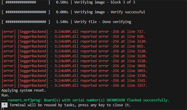

Hi all,

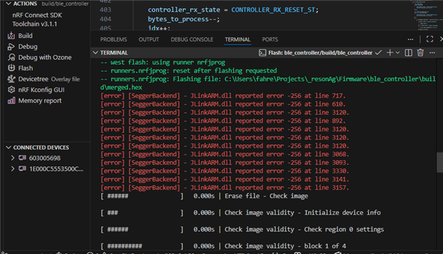

I recently updated all Segger JLink software using the Segger download links and updated the probe as prompted by VS Code NRF Extension. Up until about two days ago, before the updates, flashing worked very well and without issues.
Since today, I get the following errors on screen:
It seems though that the flashing does work correctly, because the firmware gets updated on an NRF52840 (u-Blox Module) custom board.
Additionally, the VS Code extension now recognises an STM32 debugger, which didn't happen up until yesterday or two days ago.
Any ideas what it may be?
Cheers,
Alberto

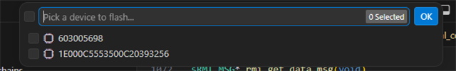

  • So, I downgraded to v8.20 which is 1 year old, that doesn't show the error message anymore.
    I still get both debuggers showing in VS Code however, and each time I need to choose which one I can use:
    Is there a way for the flasher to remember which one it uses by default?

  • Could you do nrfutil device list and paste the output?
  • My mistake, this is for the Debug option not the Flash option. My guess is that this comes from a new update of the extension. I will check with the team, could you share the support information as shown in the attachment?
  • The attached file is the output of the support information:

  • Hi Alberto,
    Sorry about the confusion here, but Benjamin is currently OOO, so I'll take over this case for a bit.
    It seems to me that the issue in the original post was taken care of, and solved by using the recommended JLink version. Though a new issue, that you are currently discussing, is how to connect an app to a specifc device in VSC? If so, have you seen this?
    Elfving
  • Hi Elfving,
    Thanks for your answer. That was the solution I was looking for. I just tried it and it works.
