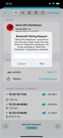

  2. Provision the DK using the nRF Mesh mobile app.
  3. Initiate a connection to the SMP Service using the nRF Connect mobile app.
  4. When prompted for pairing, enter the passkey and complete the connection.
  5. Switch back to the nRF Mesh app and attempt any Mesh communication.
  6. The error "Failed to send proxy message (err -22)" occurs.

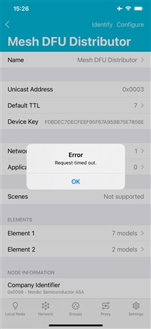

Observations: After step 6, Mesh communication could be resumed by performing any of the following:
  • Rebooting the DK.
  • Restarting the nRF Mesh app.
  • Disconnecting the Mesh Proxy Service in the nRF Mesh app and then reconnecting.

  • Hi Hieu, thanks for your reply.
    I cannot reproduce your issue. I am using an Android device though, so that might affect things.
    I am using iOS (iPhone Xs Max) and iPadOS (iPad mini 6th), and the issue occurs on both devices.
    The version of the nRF Mesh app I am using is 4.7.0.
    Regarding Android, I tested with an older device (Android 8.0.0) and found inconsistent results depending on the app:
    (I was not aware that there were two different mesh apps for Android as I primarily develop on iOS.)
    • nRF Mesh app (v3.4.0): The issue did not occur.
    • nRF Mesh (New) app (v0.9.2): The issue did occur, same as on iOS.

    Do you mean Mesh operations on the other nodes, and not the Distributor node?
    In step 5, I am performing operations directly on the Distributor node via the nRF Mesh app. Specifically:
    • Swiping down on the Node Details screen to read the Composition Data.
    • Sending messages to a Model, such as reading the Fault Status of the Health Server.
