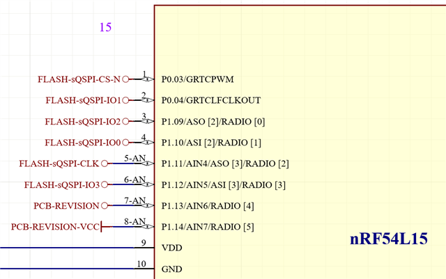

Hello.
Is it valid / ok this combination of ports for sQSPI of 54L15 to communicate with a flash memory?
Regards.

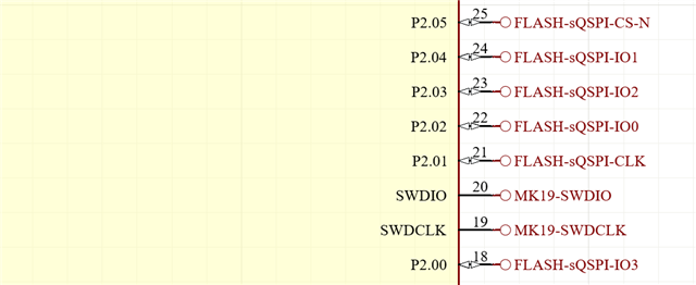

Hello Simon.
So, is this ok?
Regards.

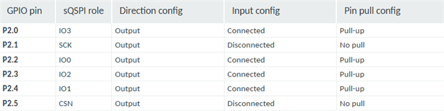

Hi Jeferson
The pin numbers and names doesn't match the nRF54L15 pin assignments correctly here. https://docs.nordicsemi.com/bundle/ps_nrf54L15/page/chapters/pin.html
The recommended configuration is as follows, and you don't seem to use these pins for anything else, so the simplest would be to just follow the GPIO configuration:
Simon

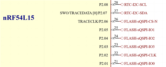

Hi Simon. Thanks.
I was able to route (with lenght match of the traces) using the pinout below.
Looks good Jeferson!
