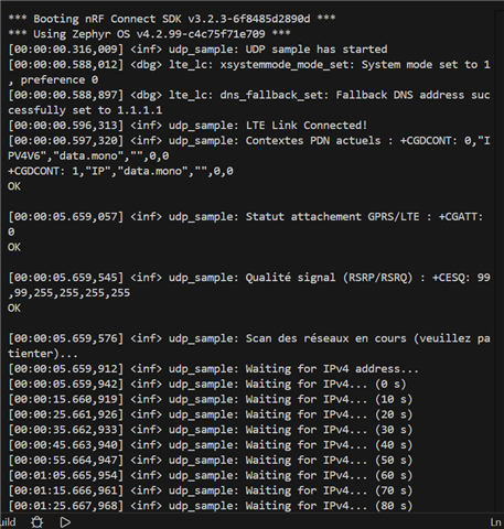

Hi everyone,
I am currently working with the nRF9151DK using nRF Connect SDK v3.2.3 (Zephyr OS v4.2.99). I am trying to run a basic UDP sample with a Terrestar Solutions SIM card, but I am unable to get a network attachment or an IP address and then unable to send data.
Here is my current setup:
Board: nRF9151DK
Modem Firmware: mfw_nrf91x1_2.0.4
APN: data.mono (configured via CONFIG_PDN_DEFAULT_APN)
System Mode: Tested both LTE-M (Mode 1) and NB-IoT (Mode 2)
Thanks in advance for your help!
