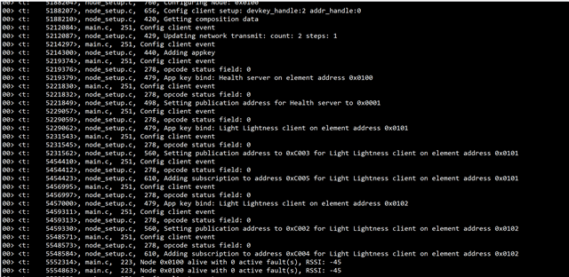

i find it in ncs: zephyr\samples\bluetooth\mesh_provisioner and i tested it,here is a question with this code:
this demo can only provision device with app key, as logs shows:

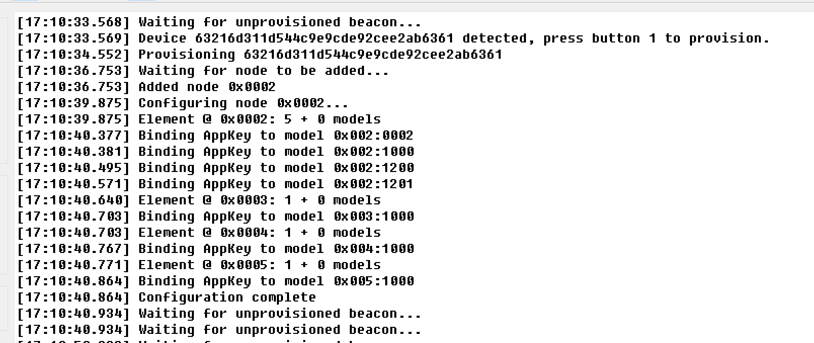

however, compared to nrf5 sdk, our provisoner demo in nrf5 sdk can provision device, also we can set up publication and subscribe, as below:
here is my questions:
1. do we have reference code or demo as same as in nrf5 sdk, so proisioner can set up the group for publish and subscribe?

    for this i mean, the code in 54l15 here in ncs: zephyr\samples\bluetooth\mesh_provisioner.
    i wish we can provide provisionerI(54l15) demo can set up the group for publish and subscribe after provision those device,as we did in nrf5 sdk: nrf5_SDK_for_Mesh_v4.2.0_src\examples\provisioner.
    William.
    I see that most of your questions seems to be for provisioner on the nRF, and not on smartphone.
    Please note that the provisioner in nRF Connect SDK is in the Zephyr part of the SDK, and has limited functionality. There may be differences between the Bluetooth Mesh samples in the Zephyr part of the SDK and the ones in the nrf part. For Bluetooth Mesh we recommend following the style of the nrf samples, not the Zephyr samples.
    The provisioner example in nRF5 SDK had functionality for setting up nodes from basically all of the other Bluetooth Mesh examples. The (Zephyr) provisioner sample of nRF Connect SDK does not come with this functionality out-of-the-box, and so must be implemented using the available APIs. We don't currently have reference code or demo for this, no.
