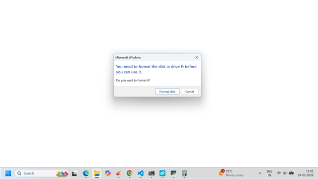

then the flash enters 4-byte address mode, but the read/write data becomes corrupted, and file system mount failing.

Issue:
  • With SFDP BFP table → Flash does not enter 4-byte address mode
  • Without SFDP BFP table → Flash enters 4-byte mode but data is corrupted
