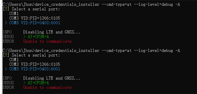

Device_credetials_installer.py cannot be used
Hi:

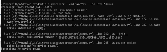

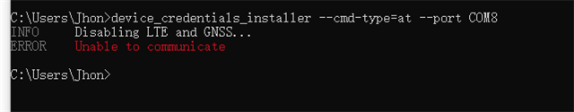

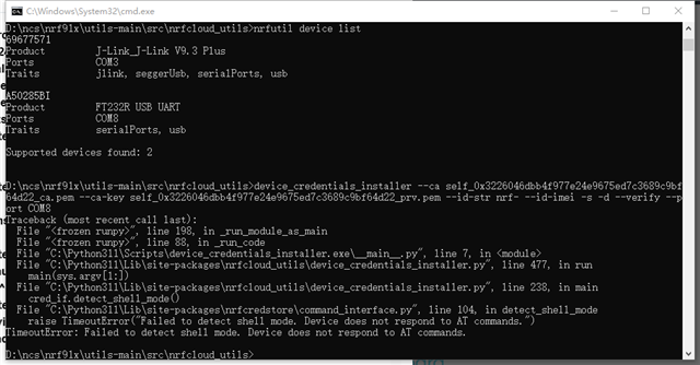

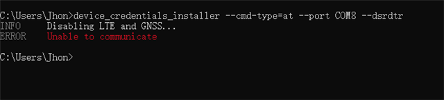

I would like to use the Device_credetials_installer.py script to generate and install device certificates (including public/private key pairs) for the device.

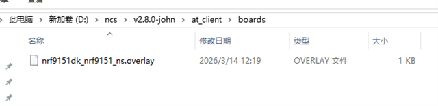

ncs v2.8.0 and example at_client.

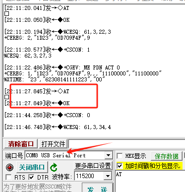

I tested the serial port and there were no issues.
But when I use Device_credetials_installer.py, it doesn't work. I don't know why.
Customize nrf9151 board.
Parents Reply
  • Hi again!
    And here is the solution. The device_credetials_installer is using hardware flow control (CTS/RTS) by default, as this is used on the interface of the Nordic DKs. This is deactivated in your configuration, so you will need to call the command with the hardware flow control deactivated as well, using the flag --rtscts-off. You can test with the following command:
    device_credentials_installer --cmd-type=at --log-level=debug --port COM8 --rtscts-off
    It should be enough to just add the flag to your original command as well.
