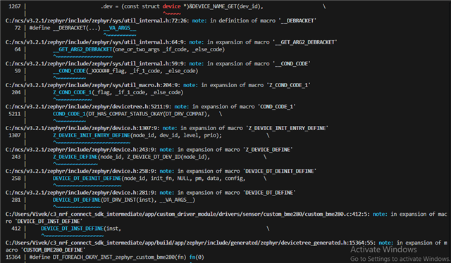

hi,
i'm learning this exercise and i got this build error.
i'm using nrf 9160dk so can anyone tell me what problem am i facing in build time error.
thanks
vivek

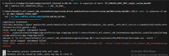

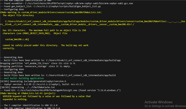

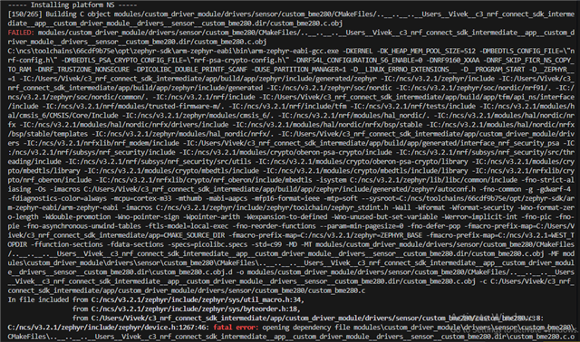

Hi Vivek,
Could you try to change this folder c3_nrf_connect_sdk_intermediate to something shorter ? for example simply change it to c3 or c3x for example.
The issue here is that when building the driver it creates a very long folder path and it exceeded the maximum 250 bytes. (Please see the first screenshot you showed).
Let us know if this change doesn't help.
hi,
i changed it and it works thanks
