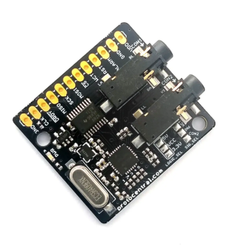

Hi, I am working on project to obtain ecg data via bluetooth. But before that I was trying to see whether I could obtain ECG signals serially through nrf52833. And I tried a lot but in segger RTT viewer, I am only seeing zeros. My sensor is ads1293 breakout board from protocentral and this one works fine because I have already used it with my Arduino UNO and I was able to get the signal. But when connected with nRF52833, I am not getting any values. What should I do?
