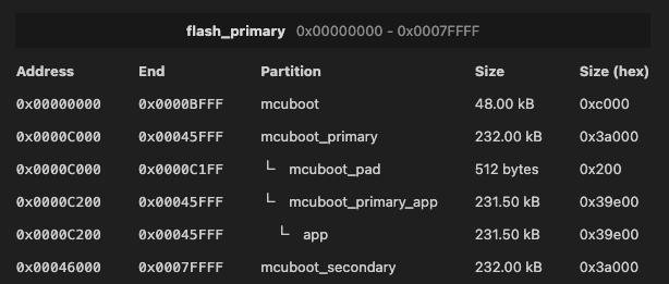

    As you have problems fitting the application of 237 kB I assume you do not have external flash for the secondary image? If so, the maximum application region will be 232 kB, and that is if you do not use the settings subsystem or need flash for anything other than the application and bootloader. For the normal case where you use transport in the bootloader (which I see you have enabled in Kconfig so I will assume you need it), you will need to fit the application twice, pluss the bootloader. Then the flash memory layout will look like this when building the smp_svr sample for nRF52 DK:
    There are some options (some of which may not suit your situation):
    1. Find a way to reduce the application size a bit further to make it fit
    2. Use external flash for the secondary slot
    (For reference, the latest nRF Connect SDK has a new Single-slot DFU with MCUboot, but this is only supported on the nRF54L series)
