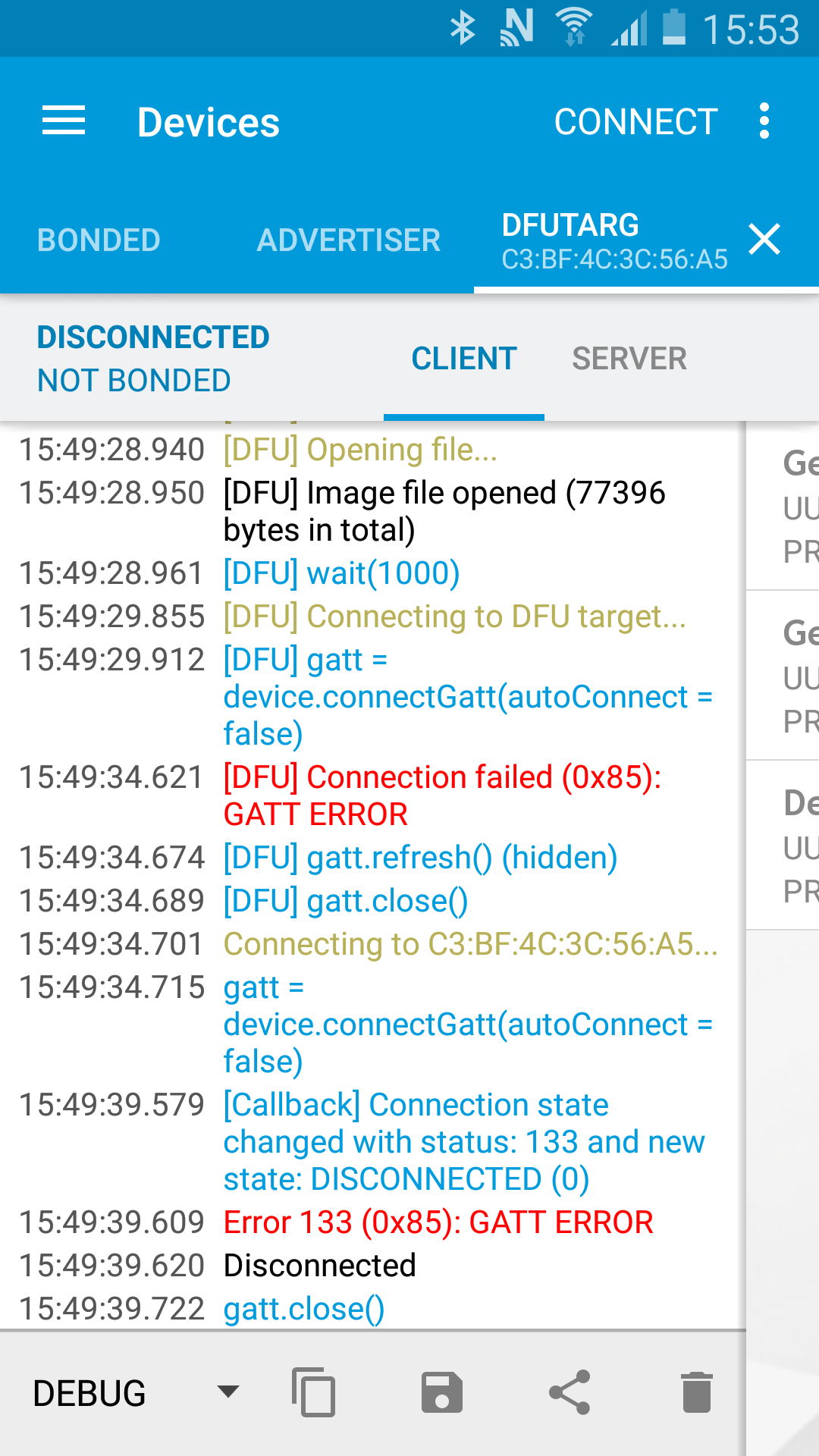

I have a problem when performing Application update over the air , after i change my boot loader.
so when try FOTA ,After i entered the DFUTarg , and then choose the application , i get the warning as shown in picture attached. and will not transfer the application.
my custom board works fine with FOTA when i use a precompiled hex file that i found online www.dropbox.com/.../sd_boot.hex from the forum developer.mbed.org/.../
Since the precompiled boot loader hex is working fine , the problem is for sure in the boot loader hex file that am generating.
The CustomBoard is 16kb Ram , am using S110 V 7.1.0 ,
