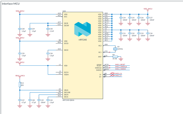

nRF52840 DK board developed off Hardware files v3.0.3 would like to get the on-board SEGGER J-Link debugger flashed on the board
We had a nRF52840 DK board developed off Hardware files v3.0.3 build.  The manufacturer didn't have any of the MCU or SEGGER J-Link debugger files on the device.  We are using SDK 3.0.2.
The board built is exactly like the nRF52840.

  • Connected the nordic nRF52840 DK Debug out (10 pin) to the nRF52840 DK build board Debug in.  The board didn't show up . (had previously done with a Fanstel and it worked)
So which steps need to be done to get the MCU / SEGGER J-Link debugger flashed / programmed onto the nRF52840 board .  Do we need to purchase a J-Link SEGGER programmer?
  • If so which model of J-Link SEGGER programmer ?
  • How would the J-Link SEGGER be connected to the board?
Can the nRF52840 DK (nordic) be used to Flash the MCU / SEGGER J-Link debugger onto the nRF52840 DK (build) ?
Would prefer the simplest and reproducible method as will need to use in production.
The basic question is have build an nRF53840 board and need to get the MCU and the SEGGER J-Link debugger on the boards.

  • The SEGGER OBD code is not available for external use. If you want access to this then you will need to buy the SW and license from SEGGER.
    All the Nordic DKs are sold as development kits and also certified as this.Development kits have different rules than end products so if you plan to include it in an end product then you will need to certify it yourself.
    All of the restrictions on use of the Nordic DKs are in licensing agreements.
    Second option for you is as Turbo J said, use an open source alternative instead. No guarantees that this will work with Nordic SW tools as these are built around SEGGER JLINK support.
