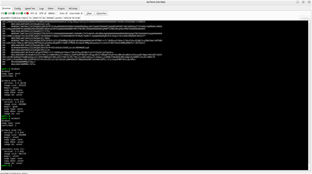

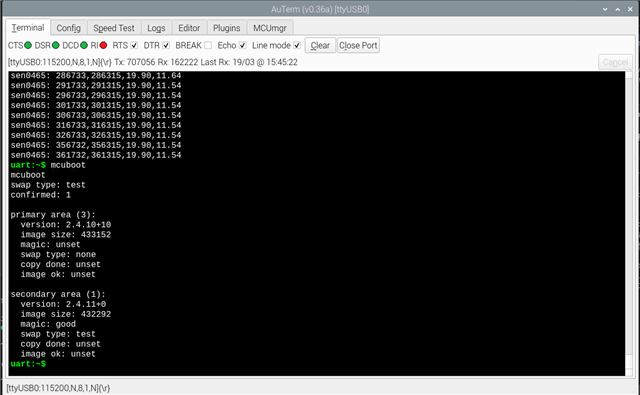

MCUBOOT Application preventing further dfu.
I recently flashed a new application onto devices that has prevented any new application images from being swapped into the primary slot. Any new images are uploaded to the external secondary slot fine, but when swaping it reverts back to the old image without ever running the new one.
mcuboot image list after attempting to flash 2.4.11
My thoughts are pointing towards configuration issues, particularly partitioning and the settings. Attached below are the configs for the original configs that were flashed via jtag (app + mcuboot) then following is the config and partition of the image that broke the updater.
