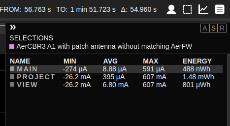

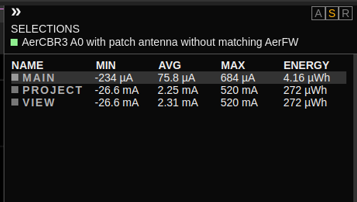

This caused the PSM current to drop from 75.8uA to 8.8uA. There are images from our testing bellow.
And if the device does not make a LTE-M connection, but goes straight to PSM the currents are the same for A0 and A1 revisions, suggesting that its a RF issue.

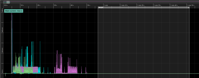

Current consumption using the device with nRF9151 A0.

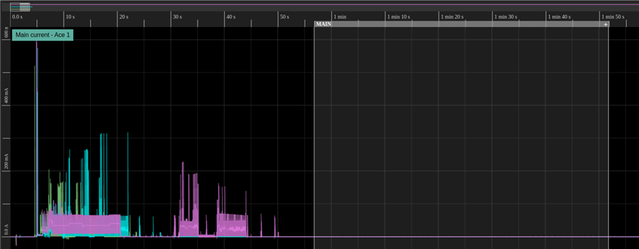

The same device but with A0 removed and A1 revision soldered in place.
