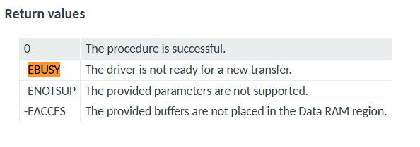

    ''What would happen if a task start happened for one transfer before the other one finished the transfer?''
    According to SPIM driver documentation, if the driver is in a busy state (transfer ongoing), a new transfer request will return -EBUSY

    However, I have not found an ready sample for your idea. There is no built-in hardware protection when a second task arrives in the mid of ongoing one. You should design your system so that the timer event only fired when GPIOTE-triggered transfer is completed.
