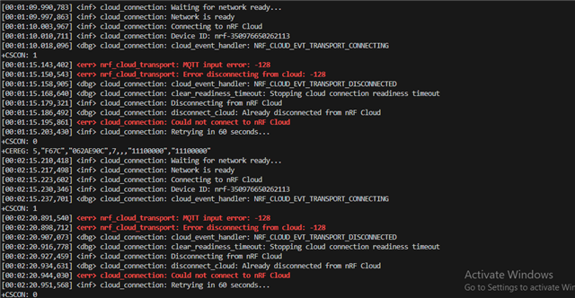

i'm learning this exercise and when i build and flash the exercise it works perfectly but then after i see this errors in the terminal

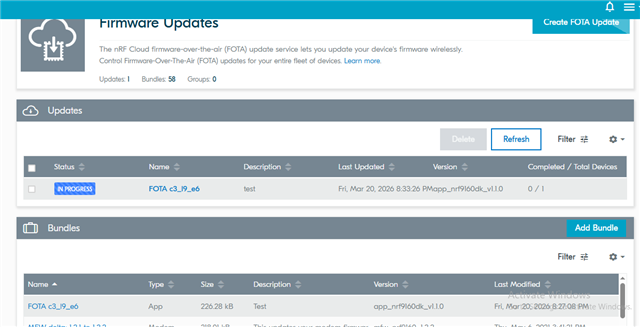

and after that i create the firmware update on nrf cloud but when i start the update, i see in progress in status bar and i can't see the updating logs on terminal as the exercise shows me maybe it's because of this errors so can someone tell me what's problem am i facing. i'm using nrf9160dk.
