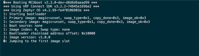

  • Hi Vidar,
    Thank you for the suggestion. I tested the softsim_static_profile sample and it works correctly, the device connects to the network successfully.

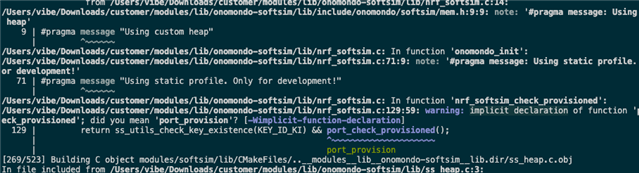

    However, when integrating SoftSIM into my full application (TF-M + MCUboot + LwM2M on nRF9151), psa_open_key returns -134 during network authentication.
    Root cause found: After investigation I traced the issue to CRYPTO_STORAGE_DISABLED=ON in TF-M's CMake build, which is set when CONFIG_MBEDTLS_PSA_CRYPTO_STORAGE_C is not enabled. This results in tfm_config.h having.
    CRYPTO_KEY_MODULE_ENABLED 0
    CRYPTO_CIPHER_MODULE_ENABLED 0
    CRYPTO_MAC_MODULE_ENABLED 0
    Key difference between working sample and my project:
    • Working sample: no MCUboot, CONFIG_PM_PARTITION_SIZE_TFM=0x10000
    • My project: MCUboot enabled + TF-M + LwM2M + SoftSIM
    hat I've tried:
    • CONFIG_TFM_PARTITION_PROTECTED_STORAGE=n
    • CONFIG_PSA_CRYPTO_DRIVER_CC3XX=n
    • CONFIG_TFM_PARTITION_INTERNAL_TRUSTED_STORAGE=y
    • CONFIG_MBEDTLS_PSA_CRYPTO_STORAGE_C=y
    • CONFIG_NRF_SECURITY=y
    • CONFIG_PSA_WANT_KEY_TYPE_AES=y
    • CONFIG_PSA_WANT_ALG_CBC_NO_PADDING=y
    • CONFIG_PSA_WANT_ALG_CMAC=y
    But TF-M CMakeCache still shows TFM_PARTITION_INTERNAL_TRUSTED_STORAGE:BOOL=OFF.
