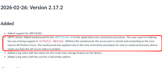

Error: One or more batch tasks failed:
* 1051278334: Failed to attach to target: The Application core access port is protected (All) (NotAvailableBecauseProtection)
The operation was unavailable for some of the devices because they had readback protection enabled. These devices might be possible to unlock using the `recover` subcommand. See `nrfutil device recover --help` for more information.
ERROR: runners.nrfutil: Flashing failed because the target must be recovered.
To fix, run "west flash --recover" instead.
Note: this will recover and erase all flash memory prior to reflashing.
FATAL ERROR: command exited with status 24: nrfutil --json device x-execute-batch --batch-path 'D:\XXXXXXXX\1-air\build_devkit\1-air\zephyr\generated_nrfutil_batch.json' --serial-number 1051278334
