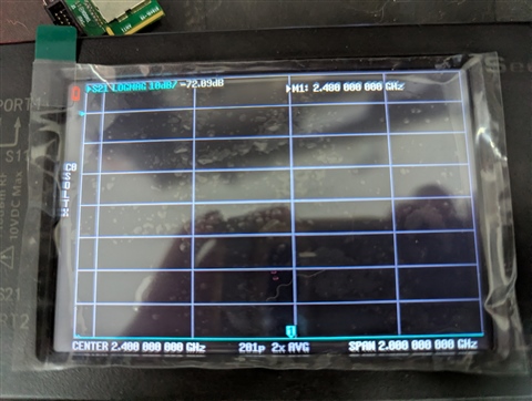

I am working with the DTM sample on nRF52840 using nRF Connect SDK (Zephyr).
My goal is to run a continuous TX test automatically at boot (standalone), without requiring UART or external commands
Setup
  • Board: nrf52840dk_nrf52840 (compatible based on direct_test_mode)
  • Hardware: Custom Board (based in Circuit configuration no. 2 for CKAA WLCSP)
  • SDK: nRF Connect SDK v2.6.1
  • Measurement: LiteVNA connected to ANT output
  • Programming: JTAG+SWD ARM Tool
What I observe
When the device boots without RTT connected:
  • Then TX stops completely X
  • TX Stops

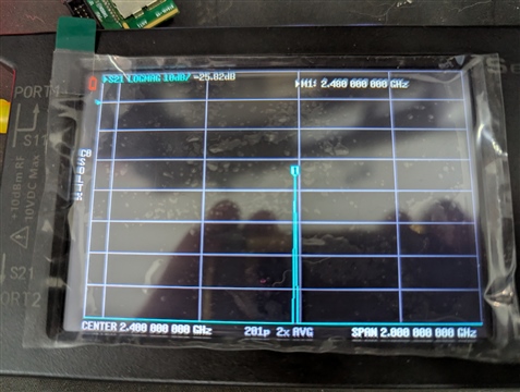

When I connect RTT Viewer:
  • Continuous TX starts immediately White check mark
  • RF signal is stable and visible on LiteVNA

  • Done, resolved — sorry for the late reply.
    The issue also occurred when using the radio_test sample. After reviewing its implementation more closely, I found a section where the DC/DC configuration is handled.
    In my current custom hardware design, the system operates in LDO/LDO mode, so I had to manually enable and configure the desired regulator mode. I executed this as a pre-kernel configuration.
    Here’s the code in case it helps someone:
