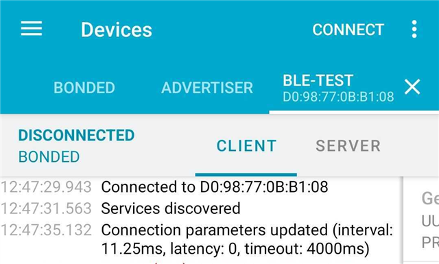

Before testing we have connected and bonded our device with nRF Connect for Mobile app.
Then we turn device off and on (power cycle) and try to connect to our device from app.
If we use nRF54H20-DK the connection is established successfully every time.

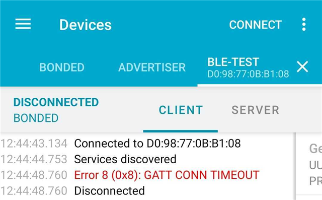

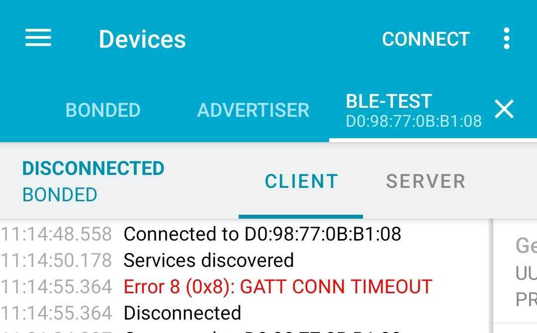

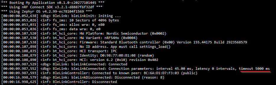

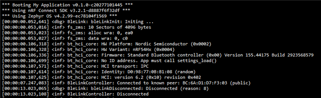

If we use our custom board sometimes we get the connection error 8. Both device and app show this error.
Also we have other samples of our custom boards. Some of them work well, but some ones have the same connection issue.
