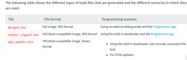

I have also attempted to program the board using the nrfutil tool straight from the terminal which does work however I notice that when i try to program it with a merged.hex file it fails but when i use a zephyr.signed.hex it succeeded. You can view the results below:

So using this information i attempted to modify the file C:\ncs\v3.1.1\bootloader\mcuboot\samples\zephyr\hello-world\build\generated_nrfutil_batch.json however due to the fact that it is a generated file the changes were overwritten.
I have tried bootloader mode as well that does not help with the NRF Connect extension but did help with programing using nrfutil tool.
Any help in getting the button in the NRF connect extension to work correctly is appreciated. Many thanks.
    Your observation is correct as the nRF Connect VS COde extension generates generated_nrfutil_batch.json wihc points to the merged.hex file. In your case, you connected thingy:91 with USB which required zephyr.signed.hex.
    You can try to program the thingy:91 with an external debug probe (for example: an nRF9160 DK) via a 10 pin JTAG cable setting SWD switch to nRF91 or nRF52 as appropriate (Building and programming with Thingy:91). Then you can use the flash button on VSCode.
