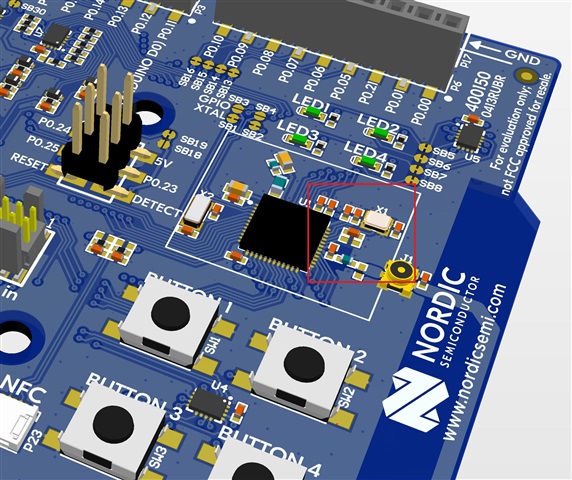

   Im trying to run a beacon sample code using VS code on nrf52832dk board. Initially, I tried running with the latest SDK available 3.0.0, but I faced MSPL assert error. So, I thought there might be some issues with the sdk version. Therefore I tried with SDK2.5.0 as well. But still facing issues, the board starts resetting immediately after starting advertising. Below is the log

    Thanks for reaching out! The MPSL error you are seeing indicates a failed HFXO startup. Which specific sample are you using and have you done any alterations to it?
    Please try to check if the crystal oscillator is actually able to start by using the code snippet Vidar posted here:  RE: MPSL ASSERT: 112, 2134 if using multiple BLE communication.

  • Hello again!
    Yes, this may indicate that there is an issue with the board. But first: could you explain how you were running the snippet? It must be run before bt_enable(). Also, you can try to add CONFIG_CLOCK_CONTROL=n in the configuration, so that Zephyr doesn't take hold of the clock. It's probably best to do the test in a blank sample, like hello_world.
    Also, could you check if the DK is OK? Specifically the area around the X1 crystal (32 MHz):
    Carl Richard
    The board seems to be fine, its as per the picture you have shared. The components are soldered correctly. And I added the snippet before the bt_enable(). Also, I tried adding the CONFIG_CLOCK_CONTROL=n in the prj.cnf.  As you had suggested I created a sample application that prints hello world on terminal. When I try building its throwing an error. But if I build without adding that line, its working. I'm attaching the log for reference.

  • Hi again!
    Ok. Does other BLE samples also fail? If so this may be a defective board.
    What is the board version and how old is it? See the white sticker in the middle.
    Carl Richard
    Apologies for the late response. It is an old board, bought around 2018 I think. So, I suppose that might be the issue, because all the BLE samples fail.
